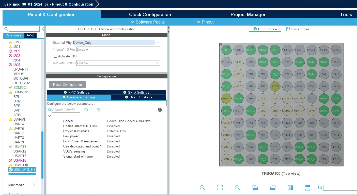

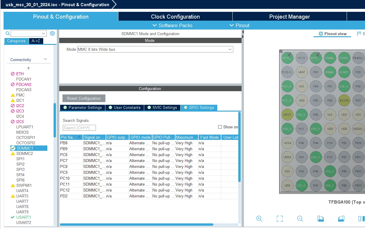

I am trying to implement a USB mass storage using USB3300, STM32H723, and e eMMC.
Project Setup:
* Clock config

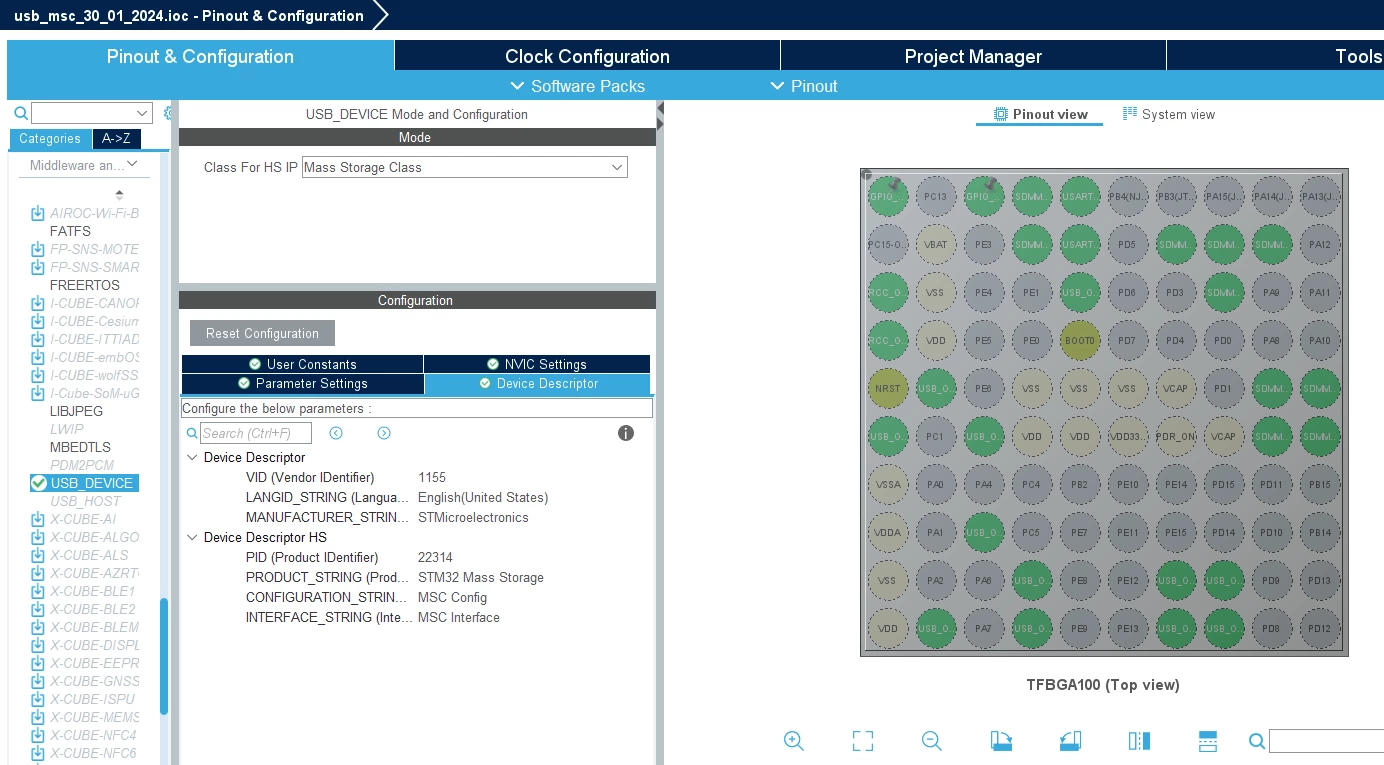

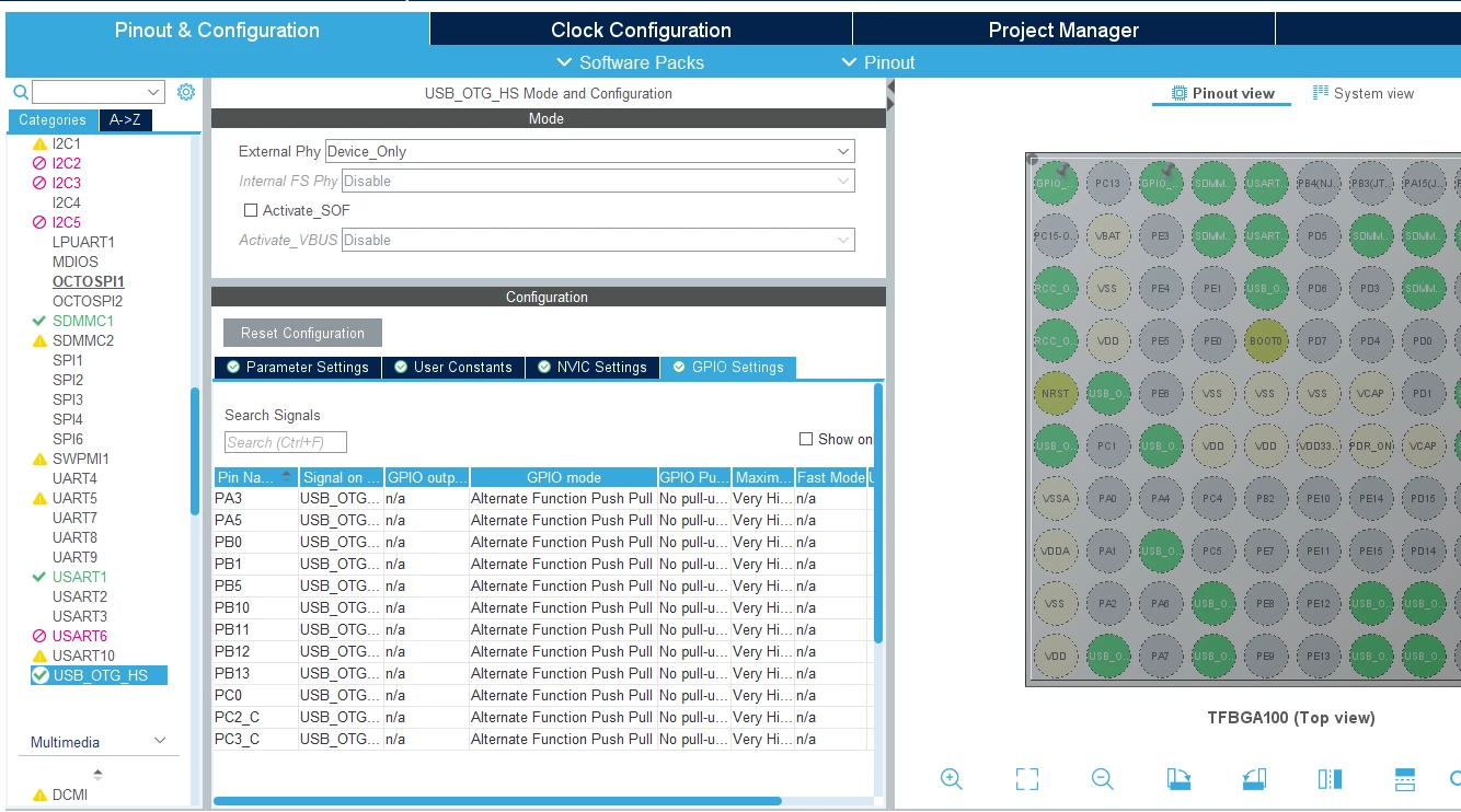

USB_HS Config
USB Device config

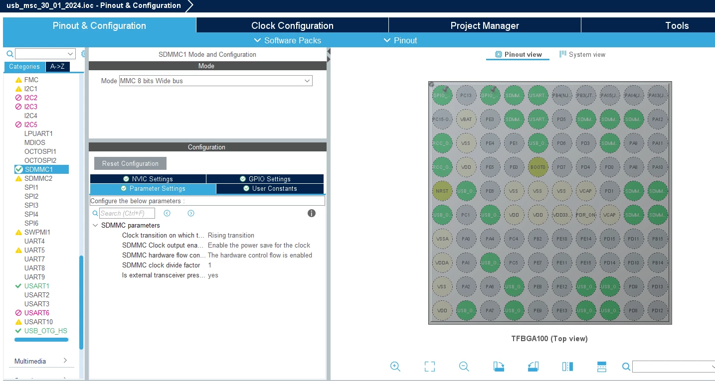

eMMC config

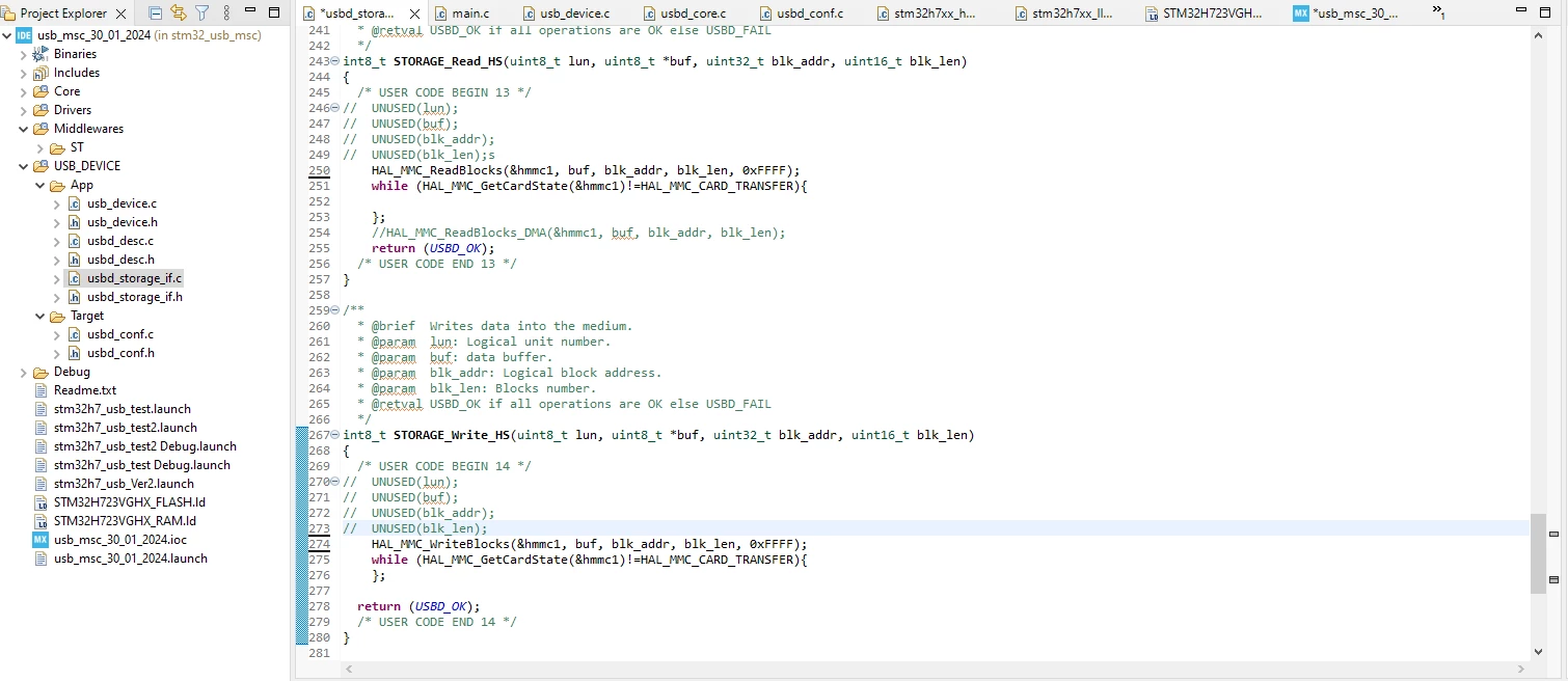

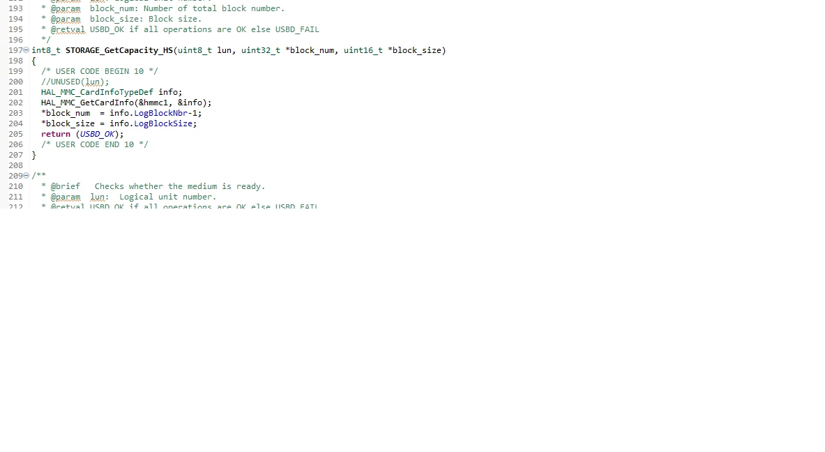

In the code I made these addons in the "usbd_storage_if.c" file:
Currently, my custom board is working as a Mass storage USB at a speed of 14MBps.
I found that when I removed the code line in function
"STORAGE_Read_HS()", and "STORAGE_Write_HS()":
while (HAL_MMC_GetCardState(&hmmc1)!=HAL_MMC_CARD_TRANSFER){
The transfer speed can be reached at 40MBps, but the data saved to the USB went wrong.
How can I speed up my USB?

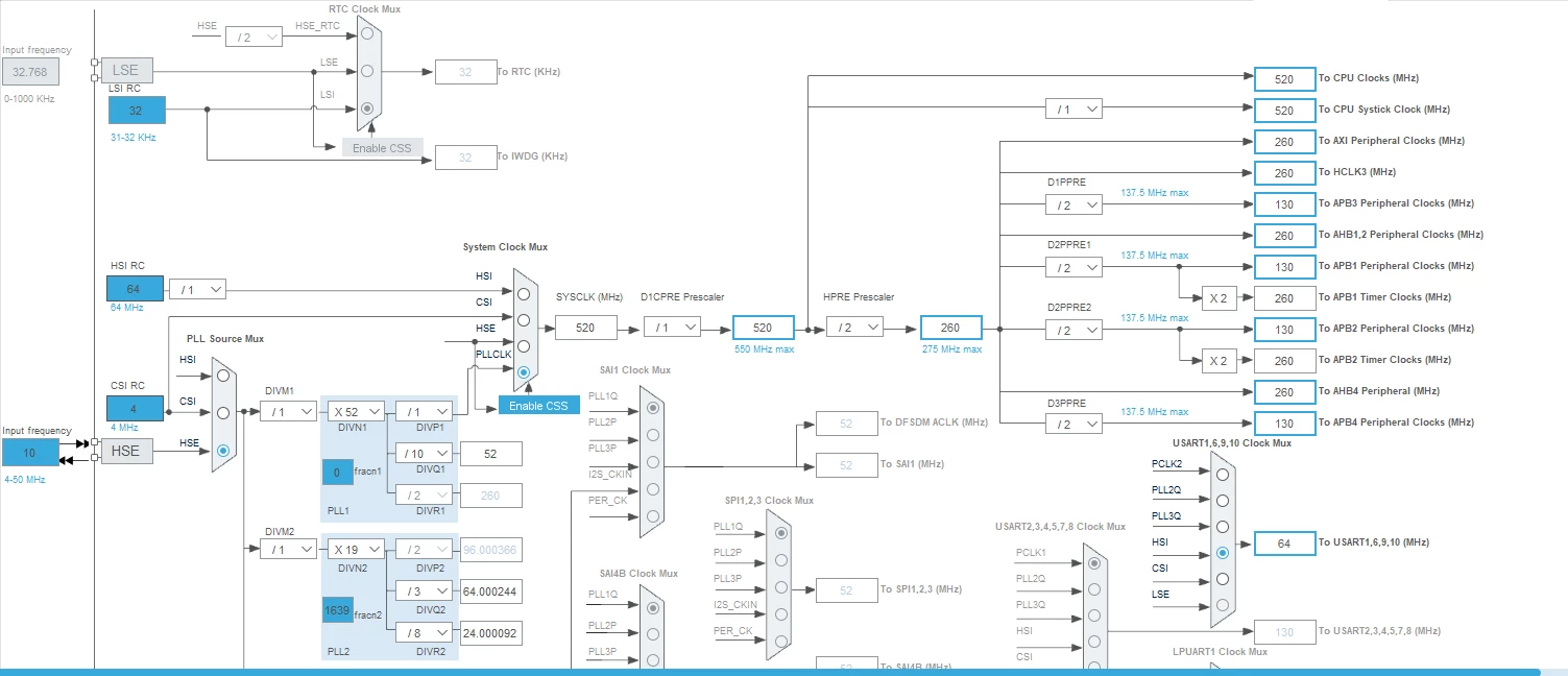

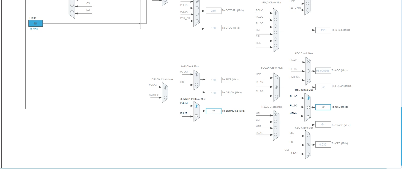

Hello @GnasUhn
Would you please check your USB clock config. The controller requires a dedicated 48 MHz clock that is generated by a PLL connected to the HSE oscillator.

Hi, FBL
I adjusted my USB clock to 48Mhz, but I noticed that the speed of the USB still did not improve (13MBps).
In STORAGE_Read_HS() and STORAGE_Write_HS() function, when we using HAL_MMC_ReadBlock() and HAL_MMC_WriteBlock(). we have to wait for CardState != HAL_MMC_CARD_TRANSFER to continue the next step.code.png
Can I use DMA to read and write in these functions, and How can I change file IOC file to do that?

GnasUhnAuthor
Apr 22, 2024 8:52 AM UTC
Hi, we followed the config of the EP1 transfer that you recommended but the speed of the USB did not change.
In my application, we do not use RTOS, the USB device is initiated by MX_USB_DEVICE_Init().
Are there any reasons that need attention in the firmware that can cause issues with the speed of the USB MSC?
