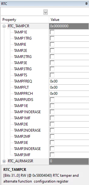

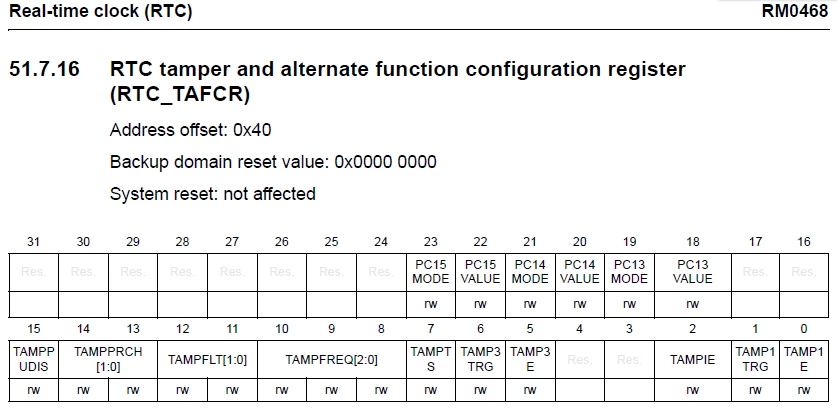

Hi everyone,
Regarding bits [31:16] of the TAFCR register in the STM32H723 RTC, I found that the RM and SVD description files don't match. Could you please tell me if the RM register description or the SVD description file is incorrect?
The differences are shown in the following figure:

Hello ​@Philister ;
Thank you for bringing this issue to our attention.
I reported this issue internally for checking and fixing.
Internal ticket number CDM0064268 (This is an internal tracking number and is not accessible or usable by customers).
Thank you.
