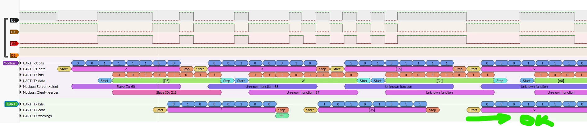

I have bought a logic analyzer from SparFun and tried to debug the fact that I am not receiving the proper data in my UART buffer.
At the input of ST485E I am getting the proper array of bytes but on the RO pin (connected to UART8 Rx) I am missing  one byte
In my case the data sent by a different board starts with < and ends with >, in the attached image you can see that on the input (A, B terminals) I am getting the proper data but on the output (RO, DI terminals or UART8 Rx Tx) I am missing one byte and the first 2 bytes are different comparing with the input.
Any idea why this is happening and how to solve this?
