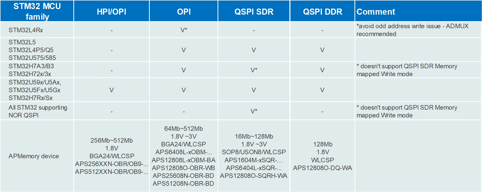

Alex - APMemory
March 30, 2022
Here is an overview of STM32/APMemory IoT RAM device supported
covering HPI, OPI, QSPI SDR, QSPI SDR per STM32 family
Hope this help
0693W00000LwLa0QAF.pngFor proto: https://www2.mouser.com/c/?m=AP%20Memory%20Technology

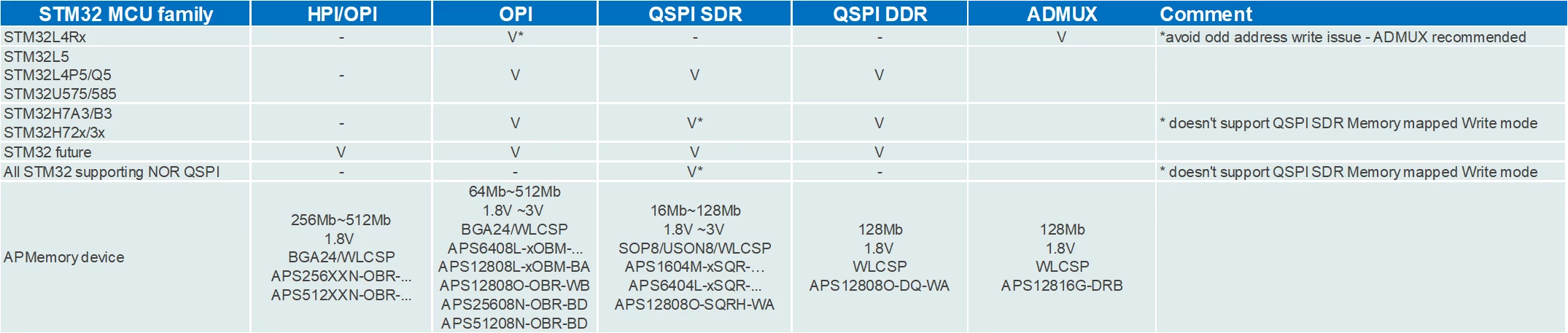

April 17, 2024
Updated AP Memory IoT RAM (QSPI, OPI & HPI PSRAM) overview with latest STM32 MCU

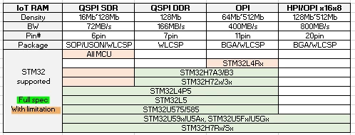

March 30, 2022
another way to show the data

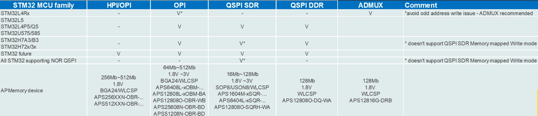

April 17, 2024
Just updating the STM32 - IoT RAM (QSPI, Octal and  Hexa RAM) support overview

From our understanding, STM32H723 doesn't support Memory mapped write for QSPI SDR (no issue for QSPI DDR and OPI)
Does the issue seen are only for Write or also Read ?

Ok that's seems good to move to OPI.
You have a wide range of option from 64Mb up to 512Mb 1.8V or 3V
OPI equivalent product of the QSPI product you have tested: APS6408L-OBM-BA
0693W00000YAGuCQAX.pngFor reference and proto:
https://eu.mouser.com/c/semiconductors/memory-ics/dram/?package%20%2F%20case=BGA-24&tradename=APMemory
Alex
