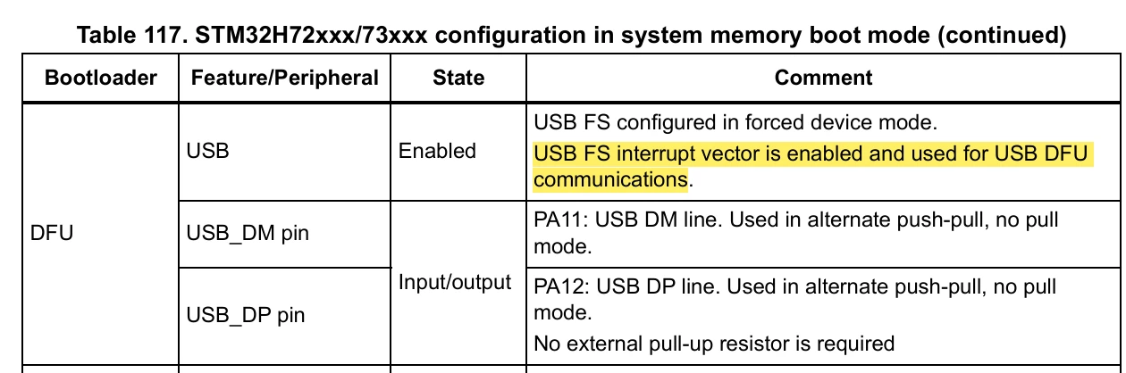

September 30, 2024
> __disable_irq();
The USB DFU bootloader requires interrupts to be enabled. Your code disables them globally.
Put __enable_irq() somewhere prior to jumping to the bootloader.
