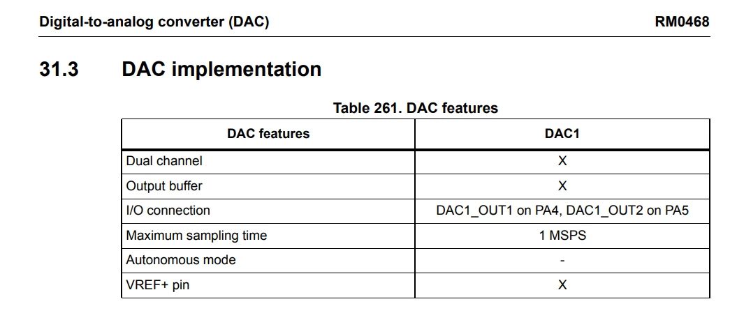

STM32H7 has one DAC instance DAC1 with two output channels on DAC1_OUT1 / DAC1_OUT2.
From the reference manual:
Almost the same same question asked in this thread.

RepwocAuthor
Dec 10, 2024 1:52 PM UTC
OK thanks.  So it appears that the datasheets are misleading at best.  I suggest that they are updated to say "1 x 12 bit, 2 channel DAC".  Then there would be no ambiguity and no confusion.

Note it's the "Product overview" web page linked to above that states 2 x 12-bit, 2-channel DACs, not the datasheet.

I will escalate that internally to fix the web page.
