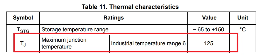

I have connected internal temperature to ADC3, and I am able to display degrees C on "Live Expressions".
The particular chip we are working with has an operating range of -40 C to + 85 C. If I am monitoring the internal temperature on a regular basis (once per second), is there a temperature that would be good for fault condition?
I am assuming I do not want to fault at 85 C, but is there a temperature that people have generally used as a condition to fault? (Is 75 C a good temperature to raise an alarm?) By the way, my Nucleo board generally runs at 30 C, after starting at roughly 26 C when first powered.

Indeed. The internal temperature sensor measures the Junction temperature (TJ) which should not exceed 125°c for the industrial temperature range 6.
From the datasheet:
That's the ambient temperature range - the internal chip temperature will be higher.
Does the datasheet give a figure for the chip-to-ambient thermal resistance?

Thanks for clarifying. It looks like internal temperature could go as high as 125 C.
I will monitor the temperature and compare to ambient board temperature, and will probably determine a fault condition based on that.
