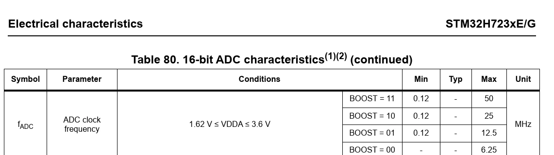

STM32H723 ADC read stuck (using LL libraries)
In my project I just sometimes need to read ADC values. I figure I could simply connect two of my signals to ADC1 and ADC2 respectively.
What it strange that it does sometimes working, but sometimes it is stuck at constant value ( maybe first read i think)
ADC is clocked from PLL at 100MHz

So I have two question:
Does any one can spot a problem, or tell my why I simply can't read ADC->DR register  if i am running only single channel per ADC ?
Thank you !

I checked the H725 Data sheet and the ADCs are limited to 50 and 75 MHz. Check the H723 data sheet for maximum ADC frequency.

AScha.3
July 15, 2023
50MHz max.
