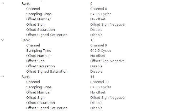

I am currently a bit struggling with the ADC Conversion via DMA. My software is working with many other ADCs, but for some reasons, if I am using following ADCs, the values from the DMA-Controller do remain zero, even though the DMA transmission has been successfully finished:
  • PF7: ADC3_INP3
  • PF8: ADC3_INP7
  • PF9: ADC3_INP2
  • PF10: ADC3_INP6
If I replacing PF7 with PF6 it seems to work again as expected, therefore I don't expect any bugs from my side. Are there any known issues with the DMA controller related to those pins?

SSchn.8
SSchn.8Author
November 29, 2021

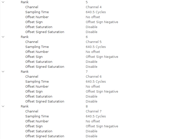

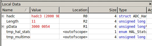

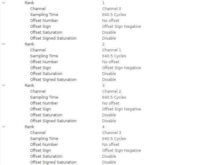

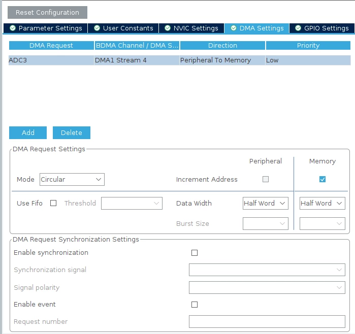

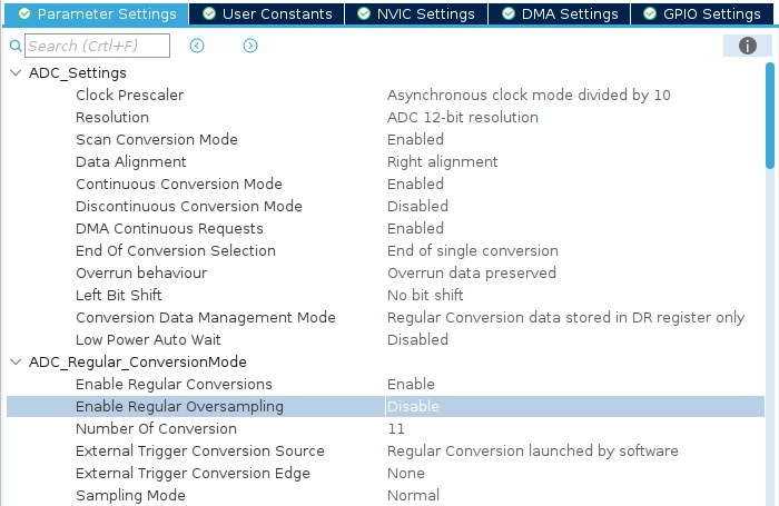

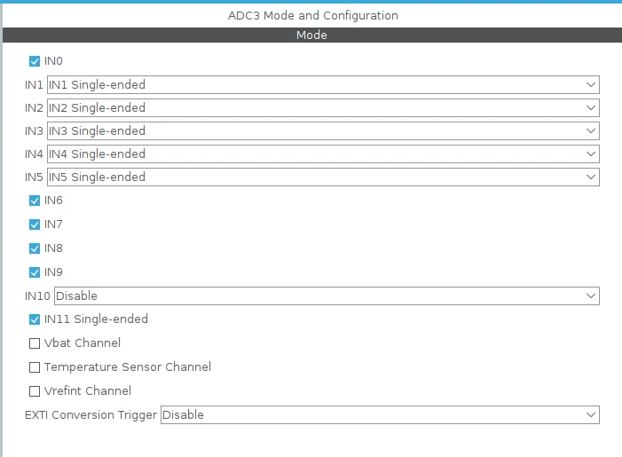

0693W00000GZDG6QAP.png0693W00000GZDFmQAP.png0693W00000GZDFhQAP.png0693W00000GZDFcQAP.png0693W00000GZDF9QAP.png0693W00000GZDFNQA5.png0693W00000GZDFDQA5.png0693W00000GZDF3QAP.pngHere some more details. You can find the necessary DMA + ADC Configuration. I am using a std::vector to handle the incoming DMA Data. You can find a snippet of the local data in the "HAL_ADC_Start_DMA" Function (I am using the addresses 0x3000 0000 and above for the DMA transmission). @Community member​ . In the Memory View you can see, that only certain memory areas are being updated (The red ones). Channel 2, 3, 6 and 7 remain zero. All channels which are before/after are working as expected.
I don't change any CubeMX Configuration, I am just using the created source code and using the HAL-Handles in my application code.
Any idea what the issue might be?
waclawek.jan
November 29, 2021
I don't use C++ and don't know what exactly this means, but dynamically allocated and re-allocated memory sounds like a potential source of problems.
Try conservative static DMA buffer allocation.
