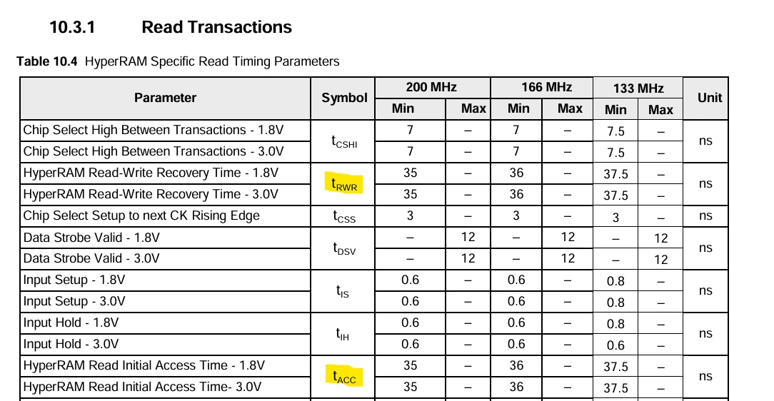

Hello ​@DMast.1 ,
I noted in the memory datasheet that the memory requires the same time for Recovery and for Access.
Why you used different values?
 sHyperbusCfg.RWRecoveryTime   = 4;
sHyperbusCfg.AccessTime = 6;
The shared OCTOSPI configuration is not correct for OCTOSPI clock 25 MHz.
Could you provide more details about the OCTOSPI clock used and share the clock configuration?

Could you please check the Recovery and for Access time, as I mentioned in my pervious comment.
The shared OCTOSPI configuration is not correct for OCTOSPI clock 25 MHz. What is the frequency of OCTOSPI use?
Thank you.

I try to use the same Recovery and Access time as you suggest but the problem still present.
Now the OCTOSPI is running @ 50Mhz.

The shared OCTOSPI configuration is not correct for OCTOSPI clock 50 MHz. Could you please refer to AN5050 Table 8. STM32CubeMX - Configuration of OCTOSPI parameters, and check your configuration.
Thank you.
