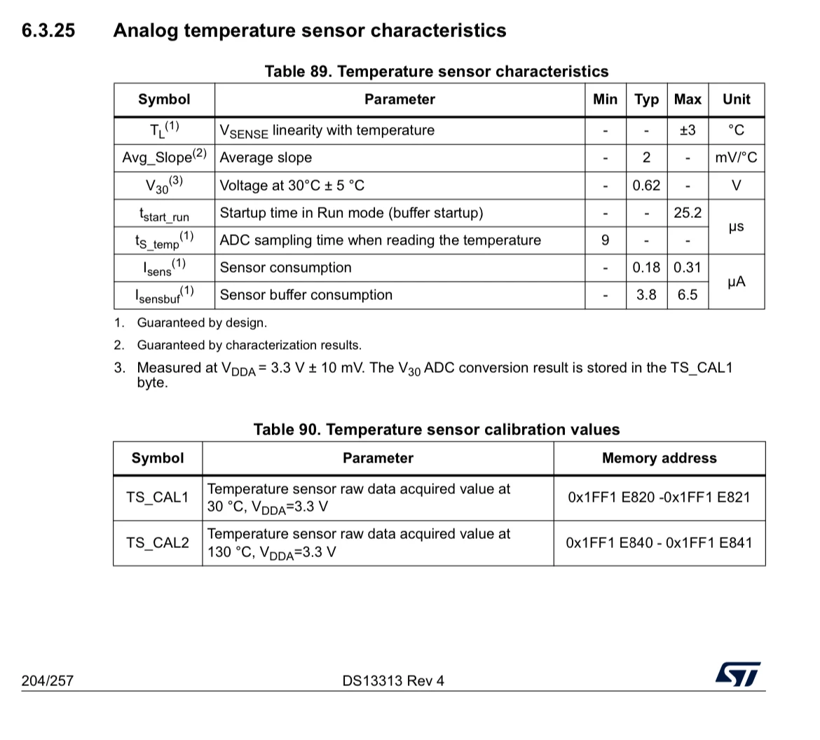

Heyho,
got my custom board running, only (minor) problem until now:
internal analog temperature sensor (ADC3) value seems to be off, showing something like ~60°C,
while an external sensor shows about 30°C.
"Finger test" confirms rather the 30°C.
I have the exactly same code running on H723 Nucleo and H735 Disco, the values I get from these make sense.
ADC3 is working, I'm measuring about 7 supply voltages on the board and the internal Vref, all these values are close to perfect.
The only difference:
VREFP pin is connected to an external voltage reference with 3.0 V, VDDA is 3.3 V, compared to the Vref 3.3V on the ST boards.
So how does this affect the temperature sensor?
Even with a factor of (3.3 / 3.0) the measured temperature is still far off.

> How does the external reference voltage of 3.0 V affect the temperature sensor?
In the same way as for any other ADC measurement. What you want to measure is the temperature sensor's voltage; for that you take ADC reading and then convert it into voltage by using the reference voltage.
Also, if you want to use the constants stored in system memory, for 'H733 they have been taken for VREF=3.3V (the DS partially incorrectly says VDDA=3.3V), so you have to take that into consideration when using them in calculation, too.

There's still the open question:
I can't find anything in the datasheet or RM, although it makes sense that the result has to be multiplied by 3.0/3.3.
But maybe there are other effects, like the TS cal values stored in flash don't make sense anymore?

June 27, 2024
Quick test, changed Vref to 3.3V, and the temperature looks good again.
It seems I have to check @waclawek.jan 's document with the formula, it's definitely not only * 3 / 3.3...

June 27, 2024
@waclawek.jan 's document showed me the solution:
yes, it is a simple correction factor 3.0 (used Vref) / 3.3 (Vref at factory calibration), but it has to be applied to the raw ADC output from the temperature sensor.

STOne-32
June 27, 2024
Dear @LCE  @waclawek.jan ,
Thank you very much for the spotting that issue and formula in our reference manual which is only valid for VDDA=VREF+=3,3Volts , another case is here and will be fixed On chip temperature sensing dependant on Vref - STMicroelectronics Community
Thanks again
