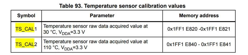

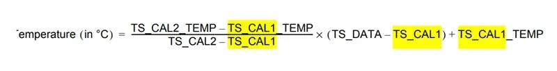

For temperature,
As per the Datasheet of STM32H743ZI, an internal MCU temperature sensor connected to ADC3_INP18 channel is factory calibrated and below are the calibration values stored into the MCU internal Flash.
Below formula will be used for actual temperature calculation. Where TS_DATA is the actual temperature sensor output value converted by ADC. also mention this formula in code above
At room temperature, it is expected to get the value of TS_DATA between TS_CAL1 & TS_CAL2 or near around TS_CAL1.  But we are getting TS_DATA = 2877 & calculated temperature = -198.098
