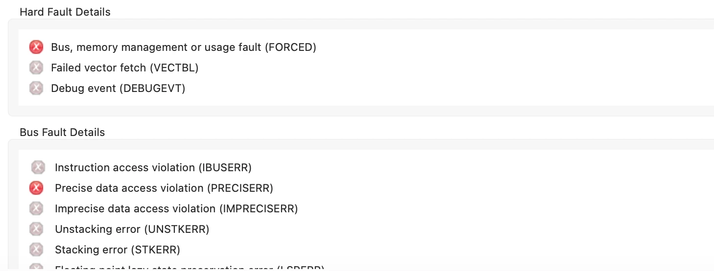

Hello Everyone,
I'm trying to write a float value into my STM32H743VIT6 flash memory, bit it jumps straight to the HardFaultHandler and I cannot understand why...

What is the value of ALTITUDE_MAX_ADDRESS? It needs to be 256-bit aligned.
Step through the code, which line does it go to a hard fault?

Hello TDK,
Finally I found the solution.
Actually, the Both functions seems good.
the 3 defines that i created during the issue were the following :
#define ALTITUDE_MAX_ADDRESS 0x081E0000U
#define FLASH_BANK FLASH_BANK_1
#define VOLTAGE_RANGE FLASH_VOLTAGE_RANGE_3
The HardFaultHandler issue occurred during the Retrieve_AltitudeMax function.
I just changed the FLASH_BANK value to FLASH_BANK_2 and it solved the issue. Can you tell me if the two functions are optimized or if i can do better?
Maybe it's not a smart question, but why this change solved the issue ? And why on this particular H7 model, there's not really explicit informations on the flash addresses on the datasheet? Does this apply on all H7 MCUs?
TDKBest answer
Feb 15, 2025 3:43 AM UTC
The reference manual is the best source of information. It will have the memory map and flash layout. The datasheet is secondary.
STM32H742, STM32H743/753 and STM32H750 Value line advanced Arm®-based 32-bit MCUs - Reference manual
