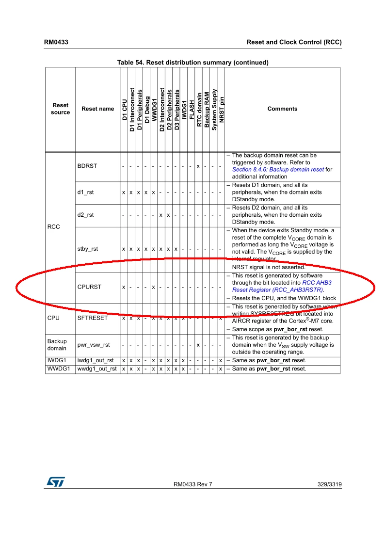

Textual search for WWDG1 reveals more funny things, e.g.
which IMO is bogus:
  • there's no CPURST bit in RCC_AHB3RSTR (nor in other RCC_xxxxRSTR)
  • IMO, CPURST does not *cause* reset of WWDG1 block, but *is caused* by WWDG1 running into reset - again, this will probably depend by WW1RSC
Textual search for CPURST reveals two other apparently related instances, one in CPU reset section of Local resets subchapter, referring to the same nonexisting bit in RCC_AHB3RSTR, and other in the changelog, which says, and I quote:
"Changed CPURST bit to in RCC AHB3 Sleep Clock Register (RCC_AHB3LPENR)."

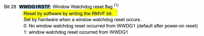

The RCC_RSR_WWDG1RSTF bit is not touched in the HAL libraries either except in LL_RCC_IsActiveFlag_WWDG1RST to check its status. So probably also a CubeMX bug if you try to use WWDG1.

The WWDG1RSTF flag is not allowed to be written by software. You can read it to see the cause of a reset, but must clear it by setting the RMVF bit. HAL provides the __HAL_RCC_CLEAR_RESET_FLAGS(); macro for this. And if (__HAL_RCC_GET_FLAG(RCC_FLAG_WWDG1RST) == SET) ... for reading.
May 6, 2020 10:32 PM UTC
You are correct of course. I still claim that it's a mess. Thanks for taking the time to write up this post and document your findings.

The reason behind this bit becomes clear when cross-checking RCC_GCR with the H745/H747 RM as these devices are actually the same as the H743 (except that the M4 is disabled on the H743): If it is cleared, only the M7 is to be reset, not the M4.

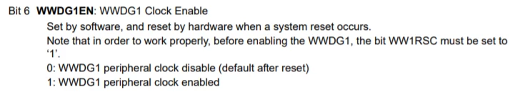

Besides to the "Caution" added in the RM and already mentioned in this discussion, we have the following description for WWDG1EN bit:
This said, it may remain not enough clear and requires farther explanation in RM. I'll raise internally other requests for documentation updates asked by Jan.

It would be great if the reference manual just stated what the WW1RSC bit does. E.g. WW1RSC must be enabled before enabling the WWDG1 to ensure a watchdog reset will cause a system reset rather than just a CPU reset. Or link to the WWRSC1 description and have that be clearer about its purpose.

The missed line of code ( HAL_RCCEx_WWDGxSysResetConfig(RCC_WWDG1); ) has been added in the "HAL_WWDG_MspInit(WWDG_HandleTypeDef* hwwdg)" function , fix is done on CubeMX 6.0.0 (available under ST.com)

I recently encountered the same issue (that the watchdog does a CPU reset not system reset). My cube project includes the following instructions for initialisation already:
__HAL_RCC_WWDG1_CLK_ENABLE();
However, the problem was that there is no DSB() instruction between them, so the CPU pipelines must have caused the enable to occur before the reset configuration got applied. As soon as I added a DSB() instruction between these two it now works.
