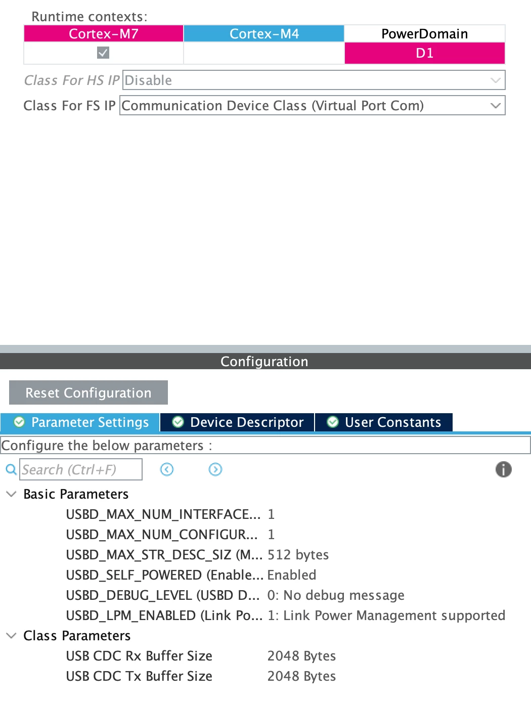

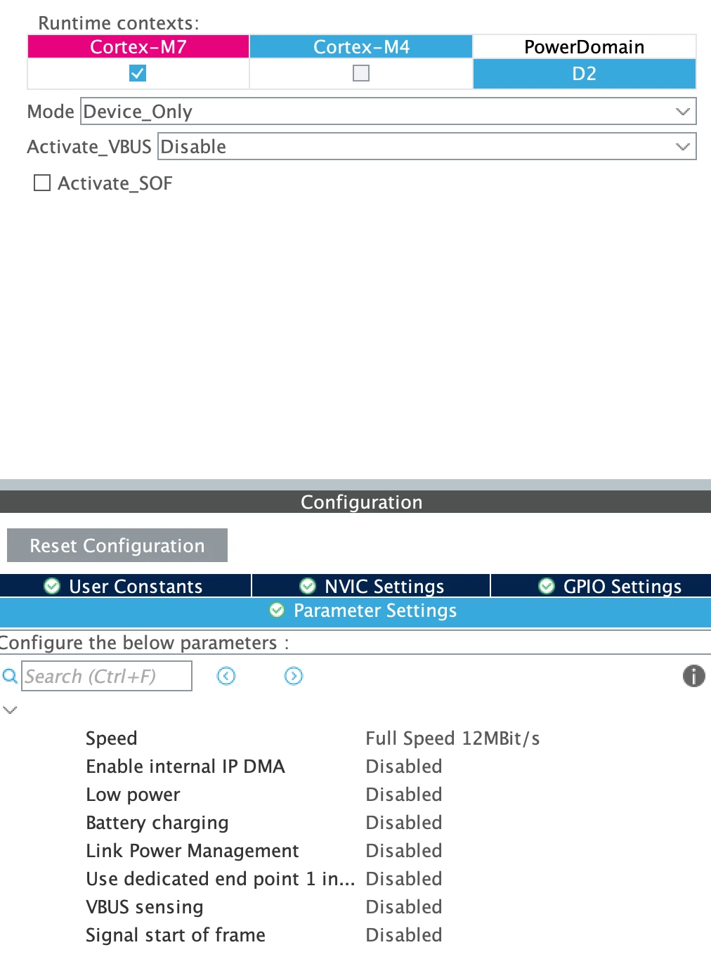

I'm trying to get a USB virtial COM Port working on the STM32 Nucleo-H745ZI-Q. I've generated some minimal code to initialize the device on PA11 and PA12 and have tried connecting a four pin USB-C breakout board to wire GND, DP, DM, and U5V, as well as simply using the provided user usb port, but no luck. My configurations are as follows in the screenshots and code.
My expected result is to view all COM ports connected to my computer and see this pop up, currently that is not happening.
- USB set to device only on CM7
- USB Clock source is from RC48
- USB device set to CDC with default settings
Any help would be appreciated, I am sure I am missing something minor here

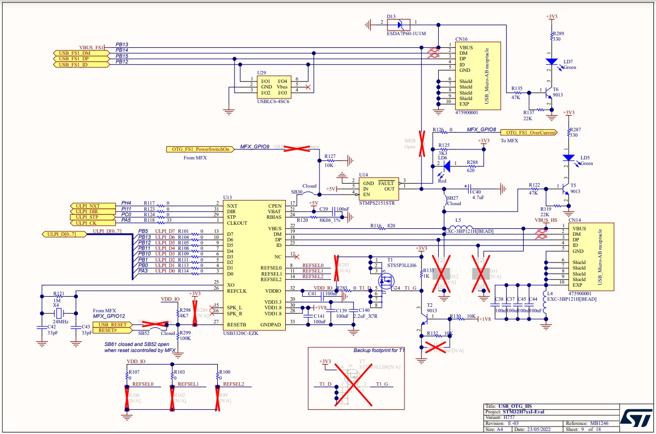

Hi @AC3
Check schematics, as long as there are no external PHY to cover high speed operations on H745 Nucleo board, it is impossible to get it working in HS.
For your custom board, you can refer to this schematics sheet 9 to develop your HS USB application.

Hi @AC3
