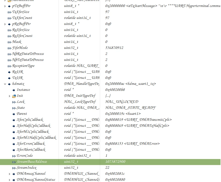

I'm using STM32H753BI. Here i'm using USART1 (PA9 & PA10) in DMA Mode. That code is generated by cubeMX and also i tried the example program of STM32H743-EVAL Board. Both are not working.

Tx buffer (aTxStartMessage) is at 0x20000000 and that's DTCM which is not accessible by DMA.

If the DMA isn't sending the expected data, check the buffer address

Thanks for your response. I understand your point. That's why I'm follow the example program for STM32H743I-EVAL Board example. but example program also not working.
HAL_DMA_ERROR_TE error bit was set while transmitting the data.

> verified the buffer address
Tell us that address.

Thanks for your response. Here I'm mentioned the DAM Address. Buffer Address is 0x400200xx..
0693W00000ANEW7QAP.pngThanks,
vel

Thanks for your response, After changing the buffer address at 0x24000000 its working..
