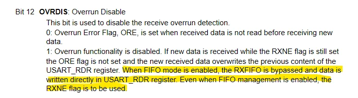

An additional check : could you try to remove the Overrun feature disabling (keeping Overrun function as usual) for a check. I'm afraid this could be interacting with the FIFO mode: See following excerpt from Reference Manual about OVERDIS bit :
 0693W00000Dq5QyQAJ.pngWhat might happen is that OVERDIS is set, only a RXNE interrupt could be triggered but as FIFO is enabled, only RXFTIE is enabled ...
