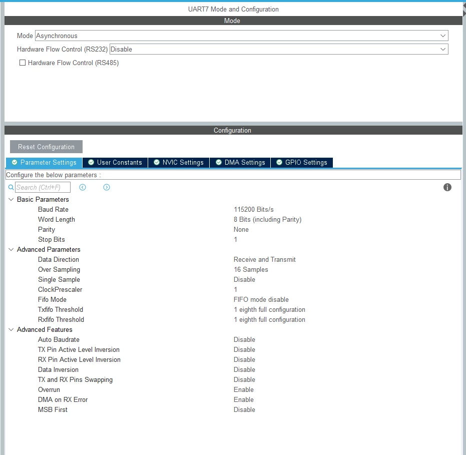

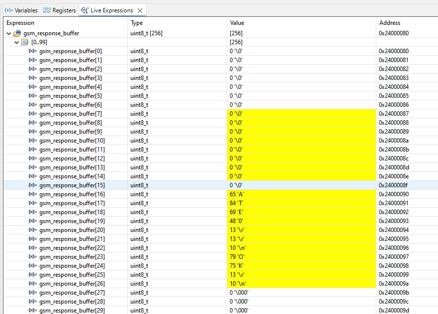

Hello ST Community,
I am working with STM32H750VBTx on STM32CubeIDE. I use UART7 + DMA with HAL_UARTEx_ReceiveToIdle_DMA()
to receive responses from a GSM modem.
Problem:

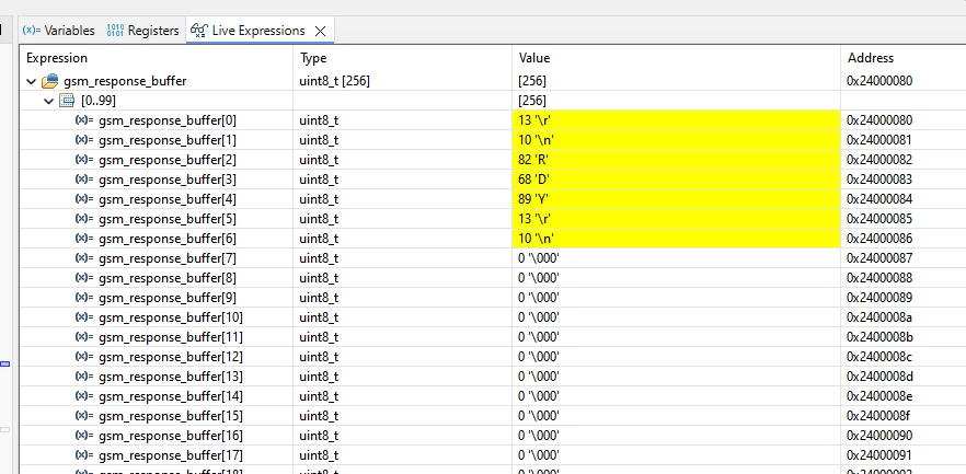

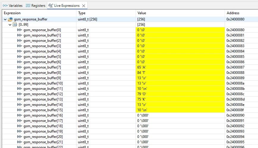

- GSM responses are stored in my gsm_response_buffer[] incrementally
- For example: first "RDY", then "AT OK", then "ATE0 OK" → all get appended
- I expected each new DMA reception to start at buffer[0].
Debug screenshots are attached.
Could you please advise how to properly useDMA reception so each new response starts from
gsm_response_buffer[0]?
Thanks in advance!

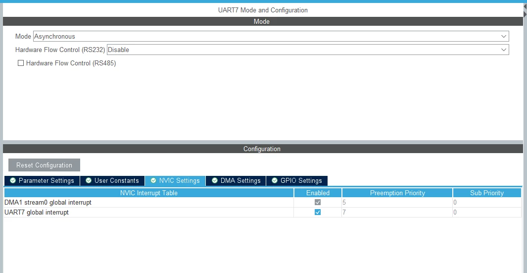

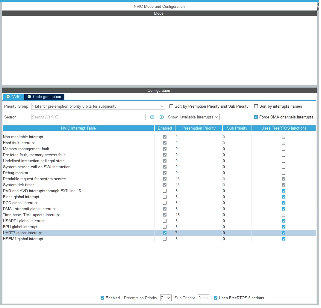

these are my ioc settings

It looks like the Rx Complete callback is only called once, at the end of all reception sequence.
In other words could it happen that all received data are sent in sequence without sufficient time between some cars to trig the IDLE event ?
A test you could make is to add a counter in HAL_UARTEx_RxEventCallback() to check how many times it is called, and try to check what is the value of Size when called.
Hope this helps

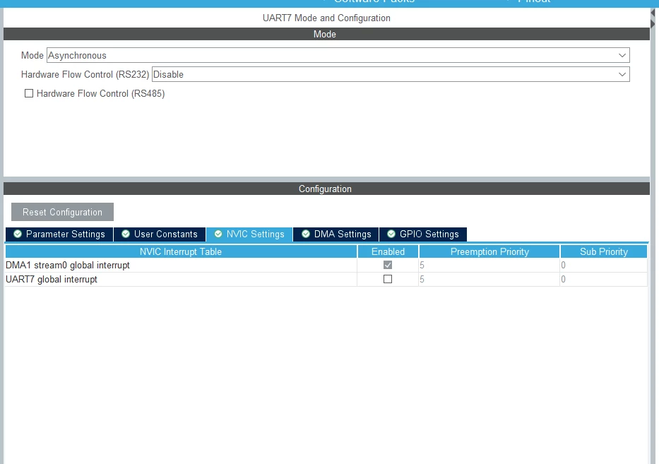

September 11, 2025
You were right the HAL_UARTEx_RxEventCallback was not getting called at all in my previous setup.
Even when i was receiving data from the GSM module.
without the global interrupt the
HAL_UARTEx_ReceiveToIdle_DMA(&huart7,
gsm_response_buffer,
GSM_RESPONSE_BUFFER_SIZE);
__HAL_DMA_DISABLE_IT(&hdma_uart7_rx, DMA_IT_HT);
call only ran once and it continued to receive the RX data.

i did this now it works *.
i enabled the UART7 global interrupt
and also increased it's preemption priority to 7 from 5

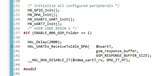

September 11, 2025
@Guenael Cadier
Another weird thing i noticed was when i ran the code without any breakpoints i got no replay from the RX line.
but when i debug with breakpoints i put one on the call
HAL_UARTEx_ReceiveToIdle_DMA( &huart7,
of /* USER CODE BEGIN 2 */
when i do this the responses came.
Now i put a delay as shown below and it worked!
```c
MX_GPIO_Init();
MX_DMA_Init();
MX_USART1_UART_Init();
MX_UART7_Init();
#if (ENABLE_006_GSM_Folder == 1)
HAL_Delay(2000);
#endif
Does anyone know why is this so?

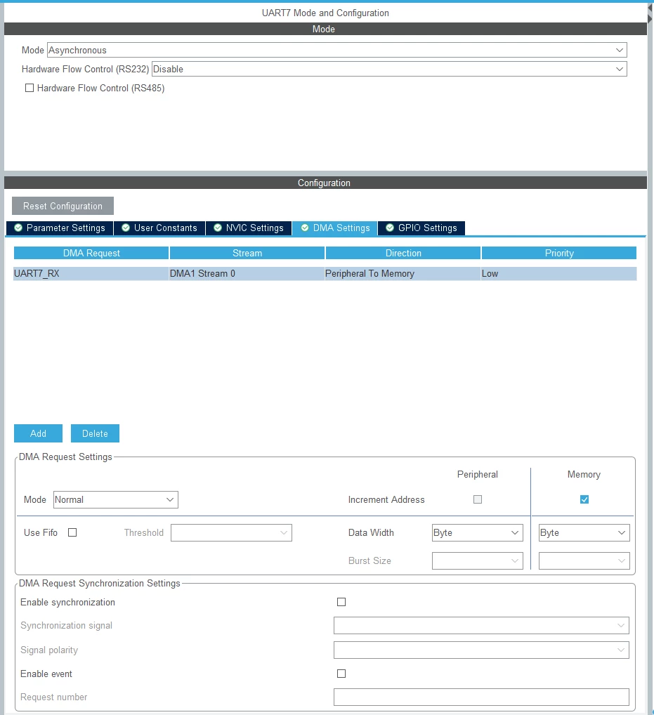

There is two ways you can go about fixing it.
  1. Don't enable Circular Mode. But you'll have to call HAL_UARTEx_ReceiveToIdle_DMA after you save your data to another buffer.
  2. You can keep Circular mode enabled, but you'll need to save your packets in a queue so that you can parse in main while loop while still receiving more packets. https://github.com/karlyamashita/Nucleo-G071RB_UART_DMA_Idle_Circular/wiki
If a reply has proven helpful, click on Accept as Solution so that it'll show at top of the post.CAN Jammer an open source CAN bus hacking toolCANableV3 Open Source

Thanks for the link.
I will try it sometime in the future.
Currently my problem got resolved by putting a delay after the initialization code.
I don't know why is this happening, if you know please inform me.

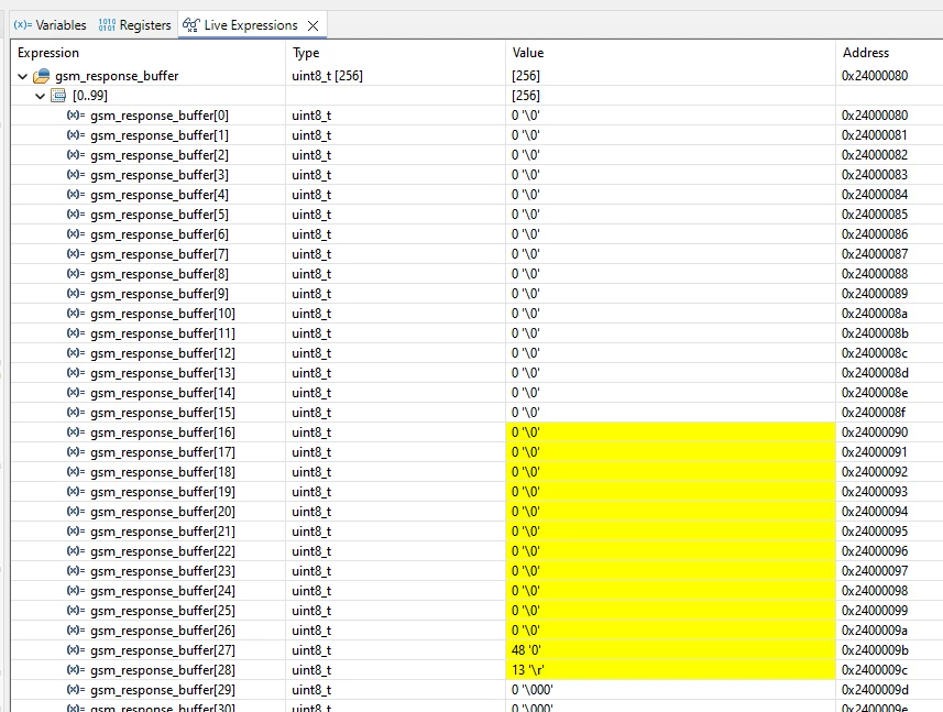

You need to restart the DMA buffer after each complete reception. By default, HAL_UARTEx_ReceiveToIdle_DMA() keeps appending until the buffer is full. In your case, once a response is processed, you should:
  1. Stop the DMA (HAL_UART_DMAStop()),
  2. Clear or reset your gsm_response_buffer,
  3. Call HAL_UARTEx_ReceiveToIdle_DMA() again with the same buffer pointer.
This way, each new GSM response starts writing at buffer[0] instead of appending.
September 12, 2025
/* USER CODE BEGIN 0 */
int count = 0;
void HAL_UARTEx_RxEventCallback(UART_HandleTypeDef *huart, uint16_t Size)
count+=1;
printf("count = %d\n", count);
printf("size = %d\n", Size);
HAL_UART_DMAStop(&huart7);
if(huart->Instance == UART7){
#endif
#endif
/* USER CODE END 0 */
I tried this it didn't work.
