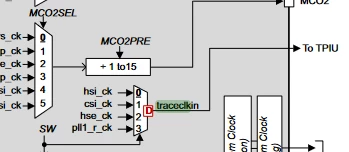

According to the RCC chapter there ought to be a multiplexer that allows to choose from a number of sources:
According to the debug chapter, it is derived from the pll1_r_ck (no mention of the other options show above):
Is this clock multiplexer for traceclkin actually implemented, or is it fixed to pll1_r_ck? If this multiplexer is actually implemented, how is it controlled, i.e. which register/bits?

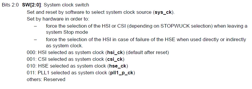

Indeed, The Clock source is controlled by SW field in RCC_CFGR register. A field common to both System clock and trace clock:
And if the system clock is on PLL1_p trace clock will be on PLL1_r otherwise it will be on HSE, HSI or CSI.

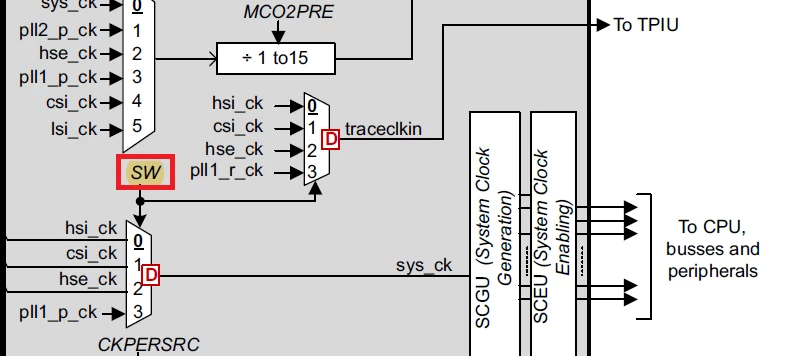

I believe I can answer my own question:
The traceclkin switch is controlled by RCC_CFGR[SW]. While that field is documented to switch the system clock (sys_ck), I guess we can assume that this actually switches both sys_ck and traceclkin in parallel. This is what the blockdiagram shows and it matches our observations, even if the RCC_CFGR documentation doesn't explicitly mention it.
