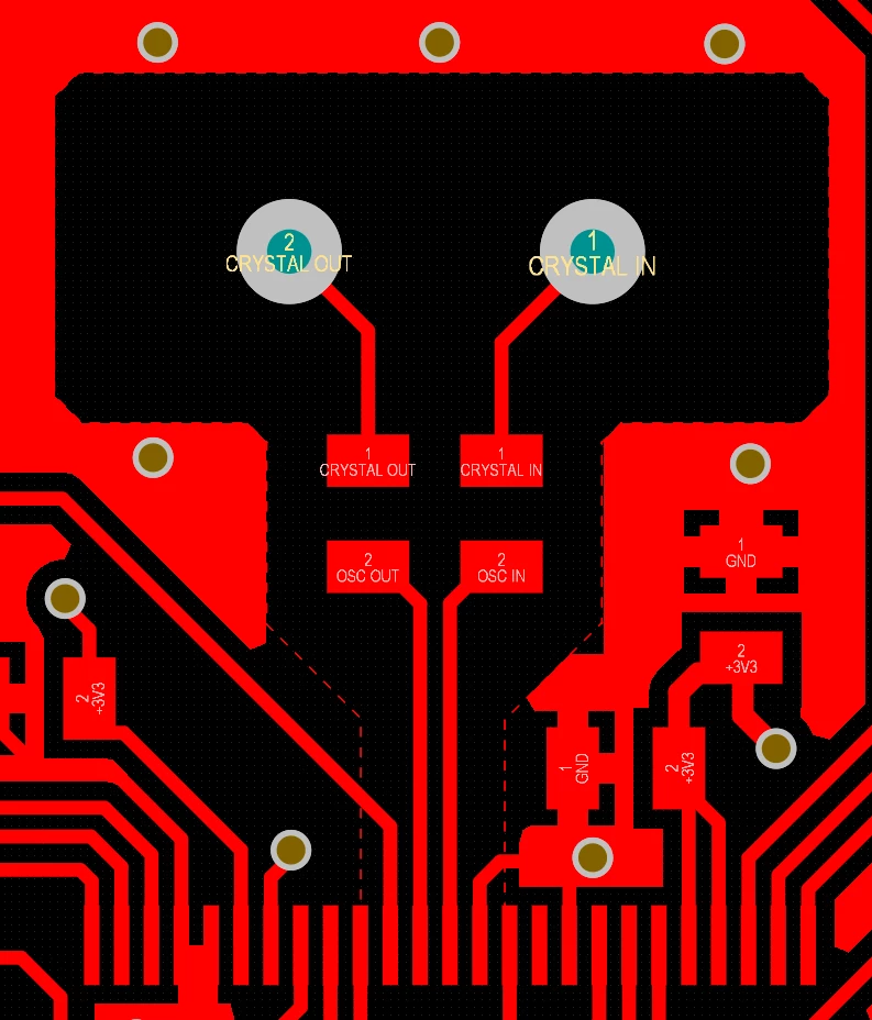

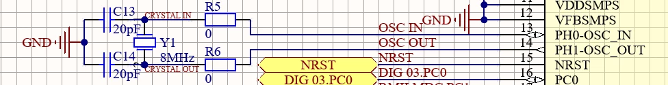

1- Please share your ioc file.
2- Need to post the part of schematics of HSE: crystal + load capacitors + the MCU.
3- If you toggle a pin with a specific delay lets' say 500ms or 1s and using HSE + the crystal, does it toggle with that delay value?

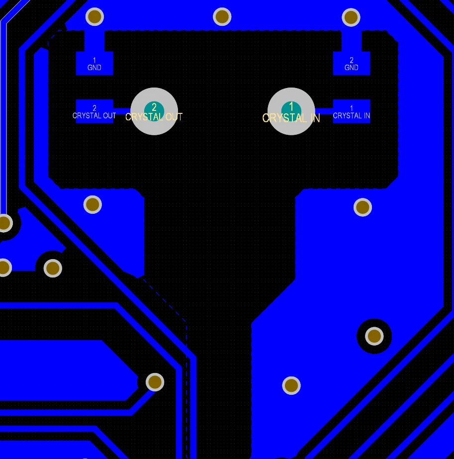

As both you and TDK suggested, I also suspect that the issue might be due to a hardware design problem with the external clock circuit.
Here are my .ioc file and the crystal design.
Thank you for all the help!

AScha.3
October 11, 2025
Try smaller caps :
12 pF or so. check.
October 11, 2025
Okay, so 20 pF load caps but crystal part number is not stated.
Guidelines for oscillator design on STM8AF/AL/S and STM32 MCUs/MPUs - Application note
Dn1teAuthorBest answer
October 12, 2025
I found out why it didn’t work. Turns out the 0-ohm resistors weren’t soldered properly. Thank you all for the advice!
