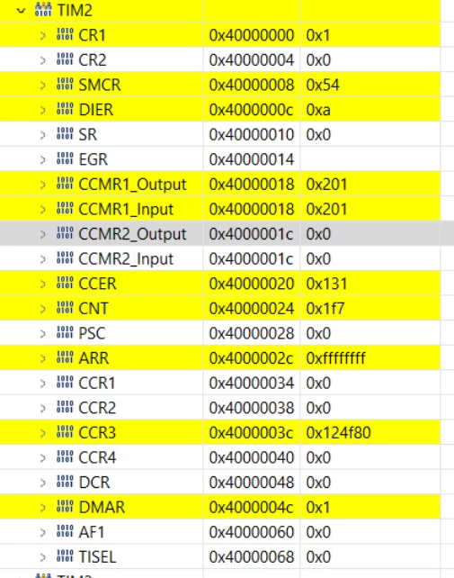

I have an odd issue.  I am setting up a timer compare channel for a 5ms delay in the future.  I set the counter to 0, set the compare value to 5ms in the future.  The compare interrupt does not occur, until the timer wraps all the way around and passes the compare value for a second time.  It passes the compare value the first time with no interrupt.
Setup is:  STM32H753 (on custom HW), TIM2, Ch1/Ch2 used for PWM input capture. Ch3 used for timeout if IC does not occur.  All setup is using STM32Cube MX.  See code below.  The timers are started with the following code:
The idea is that the PWM input rising edge on Ch1 will reset the counter every cycle (1kHz), but if the counter does not get reset due to no PWM input signal for 5ms, Ch3 compare happens.  Everything works as expected except if there is no input signal from the start, the timeout takes a full timer roller over, instead of 5ms, then is always 5ms after that!
It is like the timer needs to do a rollover first before output compare works.  I tried setting UG bit and CC3G bit in EGR, but did not help.  I even tried setting the counter to near rollover so it could roll over, but still didn't work!  I also tried removing all Ch1/2 functionality and disabling slave mode.  Just simple single channel as output compare.  Still same behavior!
Any help would be greatly appreciated.

Timer registers after all initialization and starting channels:
Observe the TIM registers after doing this: if both TIMx_SR.CC3IF and TIMx_DIER.CC3IE are set, and this did not result in the expected CC3-related interrupt service routine being called (while taking into consideration that during single-stepping in debugger interrupts are usually suppressed by debugger, i.e. you have to confirm in debugger that both above flags are set and then let the program continue running), then there's something wrong in the interrupt invocation fabric: either relevant interrupts are disabled in NVIC, or things got lost somewhere in Cube/HAL.
I'd suspect the latter and I'd write my own ISR, discarding whatever Cube/HAL is doing. I don't use Cube.
