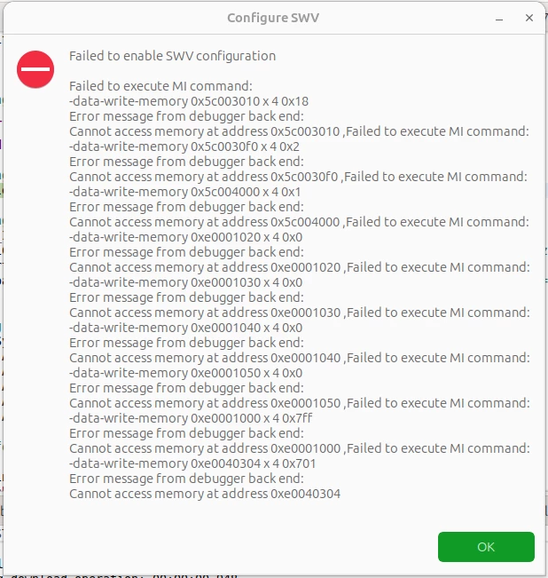

Hi, did you get a solution to this? I'm having the same problem.
SWV works perfectly with HSI and HSE directly, but not through the PLL. Trying to start the Trace errors out with the following error.

Where do you see this message? Which IDE or debugger?
ping_pongAuthorBest answer
October 8, 2024
My solution was pretty simple. The output from DIVR1 must match the SYSCLOCK. If not, it breaks. Doesn't matter what combination of divisors and prescalers are used, as long as DIVR1 matches the SYSCLOCK.
As a general solution, ensure that the clock source for the SWV is enabled, and that it matches the PLL (or other clock as required by the datasheet.)

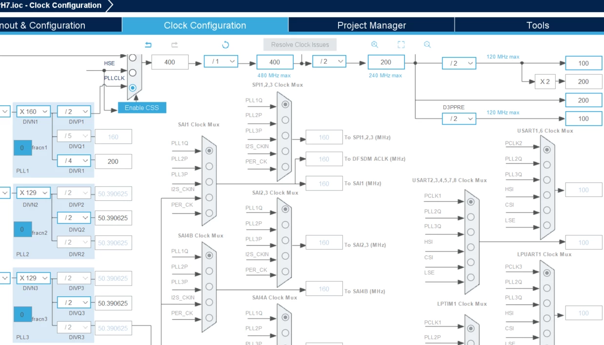

  • CM7 configured for 400 MHz using PLL, i.e. max possible frequency using switched-mode power supply (SMPS).
  • PLL1R clock set to 200 MHz - this is important
  • Debug mode set in MX to "Asynchronous Trace SW"
  • Added _write() function to my code as per normal instructions.
Working clock config as below:

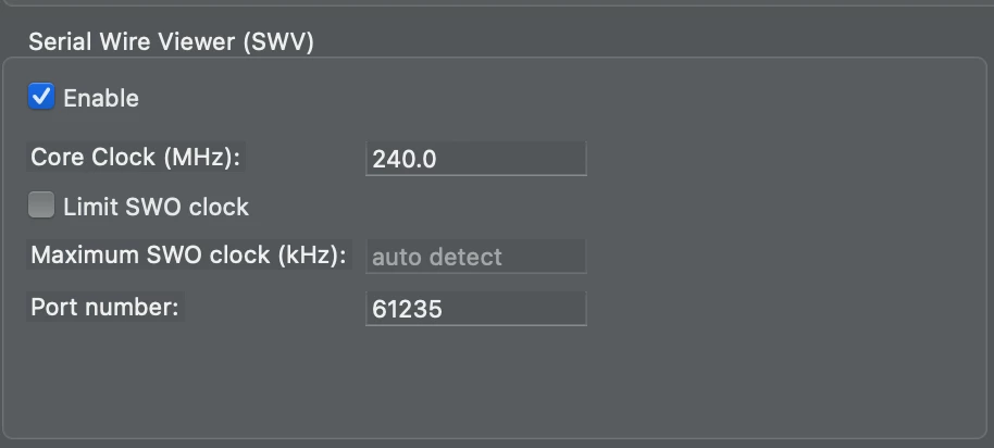

After editing the Debugger config in CubeIDE to enable SWV and setting the CPU clock speed there (alongside SWV settings) to 400 MHz, I found that printf() produces no output and variables added to the SWV Data Trace Timeline Graphs are NOT logged.
After lots of experiments I found that if I set the CPU clock in the debugger settings for SWV to 64 MHz, then I see some garbled data coming out printf() on the SWV ITM Data Console view, and occasionally some invalid data variable trace values - clearly there's something wrong in that setup.
When I changed my core clock in MX to 200 MHz I noticed a warning from MX that the PLL1R clock was too high at 400 MHz, so I changed its divisor so that PLL1R clock is 200 MHz, then with the Cube IDE debugger config now set to 64 MHz core clock setting I have printf and data trace logging working perfectly. This is strange because standard advice is that SWV's configured CPU freq is supposed to match the true CPU clock.
I then changed my core clock in MX back to 400 MHz, and despite there being no warning this time that the PLL1R clock was too high, I used the modified divisor setting to ensure that it was again 200 MHz. With that configured, and the CM7 CPU at 400 MHz, along with my debugger settings set to 64 MHz core clock, I have SWV working perfectly. Once again, that shouldn't be the case, but it works so I'm going with it until somebody gives me another solution.

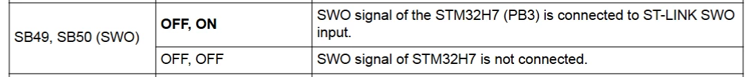

One other thing to mention about the official documentation. The H755 Nucleo User Manual UM2408 clearly states that the solder bridge config to enable SWO should be SB49 = OFF and SB50=ON, as below:
My board has both of these ON. I have not tried removing SB49 since I already have a working solution. Nor have I checked the schematic but I'm guessing that SB49=ON is enabling a pull-up/down resistor while SB50 is the important one that connects PB3 to SWO on the debugger interface.
I hope this might be helpful to other people struggling with SWV on their H75x.

You can have PLL1R different from SYSCLK but the Core Clock settings must be the PLL1R value
My SYSCKL is 480 MHz and my PLL1R is 240 MHz
