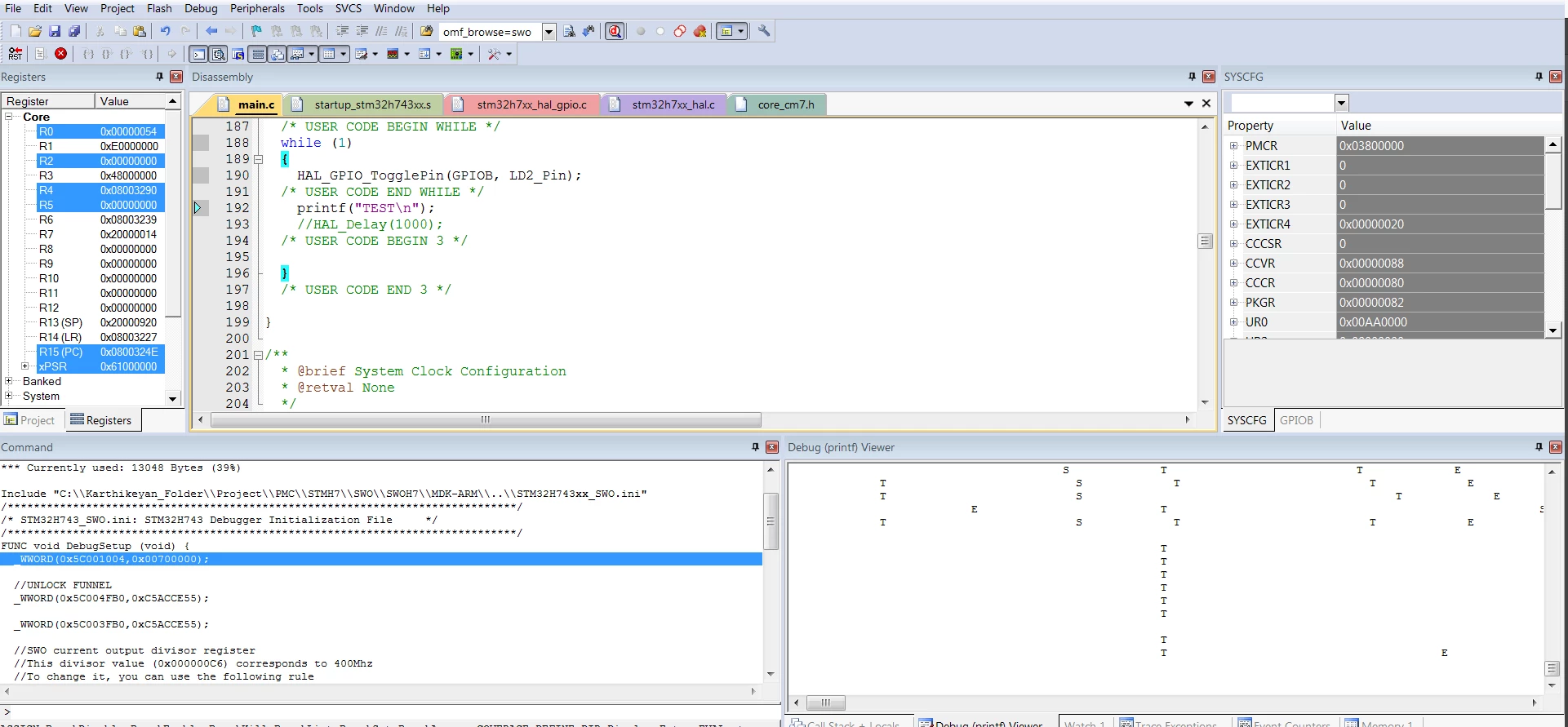

    Hi All,
    Please any help to find the root cause of below, I followed all instruction as mention above but still i'm not able to getting proper result.
    I have used fputc to print data in ITM as below,
    int fputc(int ch, FILE *stream )
     return(ITM_SendChar(ch));
    Tesla DeLorean
    Guru
    Oct 15, 2018 2:32 PM UTC
    Make sure the clock settings are coherent
    The divider needs to be set to ((SystemCoreClock / 2000000)-1)
    Torsten's method is more robust than using the debugger script.
    KVija
    Oct 16, 2018 12:52 PM UTC
    Hi Clive,
    Thanks for your swift reply. It's working fine after changed the divider value with debugging mode.
    I would like to do this same configuration with openOCD (from eclipse ). Please guide me in right path.
    Thanks a lot for pin point solution.
