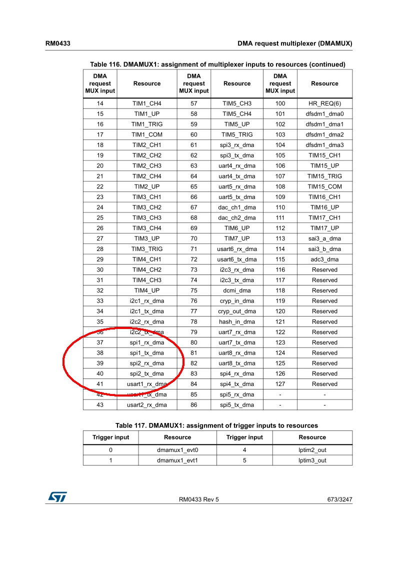

Generally, you need to:
  • enable DMA request generation in SPI (TXDMAEN/RXDMAEN, see Communication using DMA (direct memory addressing) subchapter of SPI chapter in RM)
  • 'H7 uses DMAMUX so you have to configure that too
  • and then as you've said, configure DMA itself; don't forget to clear the status flags before enabling the given stream

Dear JW,
thanks a lot for your reply. Following your suggestion, I read the chapter in the reference manual (RM0433) related the DMA for SPI, including chapter 16 (DMAMUX). Checking examples on the "STM32Cube_FW_H7_V1.5.0" package (in details, DMAMUX_RequestGen project) I tried to modify it for SPI using but I still have some doubt about the DMAMUX
In the example I found this code
dmamux_ReqGenParams.SignalID = HAL_DMAMUX2_REQ_GEN_LPTIM2_OUT; /* External request signal is LPTIM2 signal */
dmamux_ReqGenParams.Polarity = HAL_DMAMUX_REQ_GEN_RISING; /* External request signal edge is Rising */
dmamux_ReqGenParams.RequestNumber = 1; /* 1 requests on each edge of the external request signal */
HAL_DMAEx_ConfigMuxRequestGenerator(&DMA_Handle, &dmamux_ReqGenParams);
where the first instruction should be related to the external request (in this case LPTIM2 signal). I serached something for SPI but no label in this case.
Do you know where is possible to find detailed procedure about DMAMUX setting?
The Cube doesn't help.
Thanks and best regards
waclawek.jan
October 14, 2019
0690X00000AqJ8DQAV.pngJW
