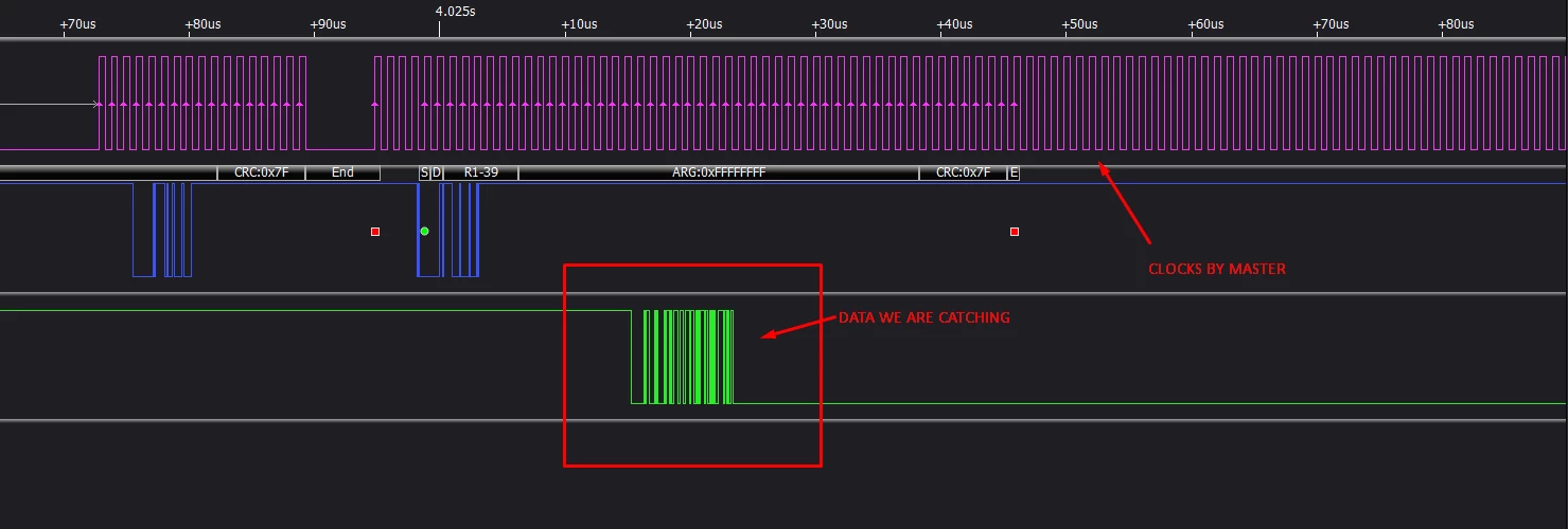

Im moving my project code from stmf407 to stm32h743 and i have stucked with spi. First of all stmh743 has many more registers and it also lack some of them like RXONLY register in CR1. What im trying to do its receive 19bytes from the master,the master is a complete device and i cant control it. The clock speed of the master is around 20nanoseconds. My previous project in stmf407 catching the data perfectly.

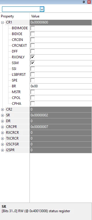

STM32f407:

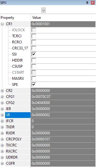

STM32H743:
as you can see stm32h7 has a lot if registers i didnt met before like FIFO and CSUPS etc... and lack of crucial registers as RXONLY.

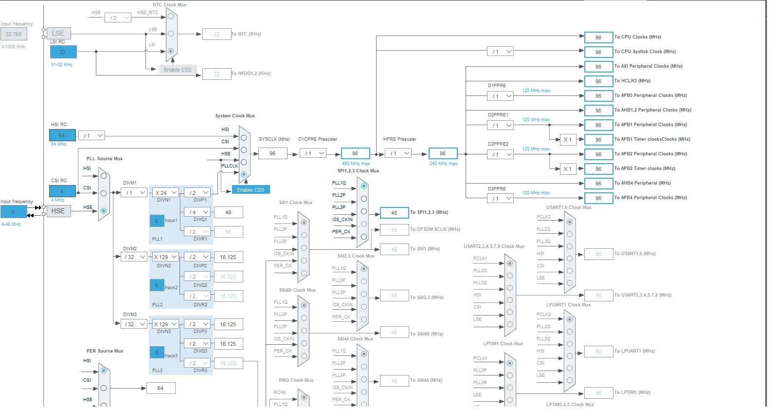

here is clock configuration of STMH743:

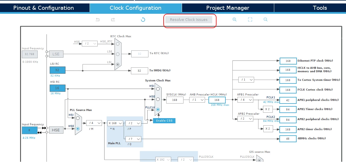

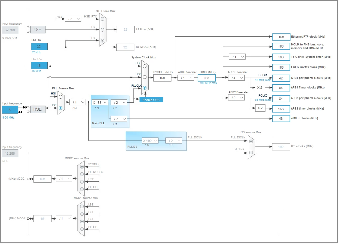

here is clock configuration of STMf407:
as you can see stmf4 has a higher clock, can it be the issue?
