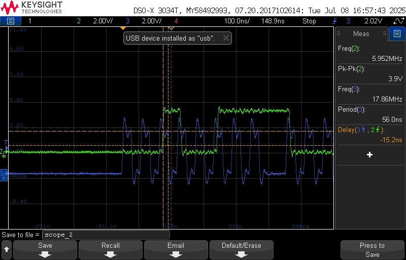

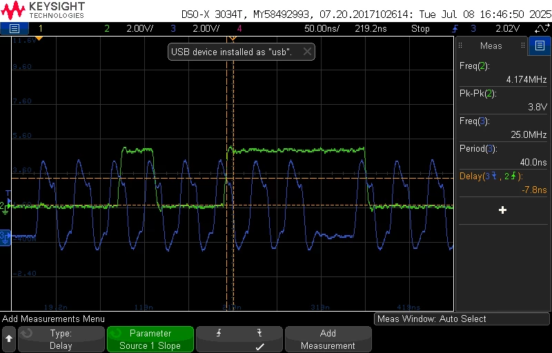

Can you show a scope trace of the first few bits of the transaction on SCK/MOSI, where the bit shift occurs?
Amit_RSAuthor
July 10, 2025
At 25 MHz: Green is MISO and blue is SCKAt 25 MHz: Green is MISO and blue is SCK
At 18 MHz: Green is MISO and blue is SCKAt 18 MHz: Green is MISO and blue is SCK
At 25 MHz I see bit shift while for 18 MHz the data is received correct. In the image: green signal is MISO and blue is SCK
July 11, 2025
Lots of overshoot/ringing on blue but none on green. Signals are also not synchronized. The rising edge of blue should line up with edges in green, but it's not. Green is lagging, and lags more with higher clocks. Don't really know why, but that's likely part of the issue. These are faults of the master SPI.
Amit_RSAuthor
July 11, 2025
The rising edge of blue signal(SCK) is not lining up with green rising edge (MISO) as I am operating in SPI mode 01 where the data is sampled at the falling edge of the clock or blue signal. For 18 MHz it samples 15.2 ns prior to falling edge of clock while for 25MHz the timing reduces to 7.8ns. Hope this helps to understand the scope readings better.
July 11, 2025
I am aware it’s in SPI mode 1. Things should still be aligned as stated.
