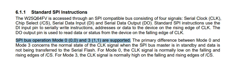

Hi team,
I am using stm32h7a3 MCU and I am trying get manufacture id from external SPI flash(W25Q64FV).
But problem is if I used SPI mode 0 then its working properly but If I used mode 3 then it is not working, However in windbond datasheet says its support mode 0 and mode 3.
0693W00000VOgpNQAT.pngMy requirement is to use spi mode 3 only.
If somebody knows about this then it is very helpful for me.
