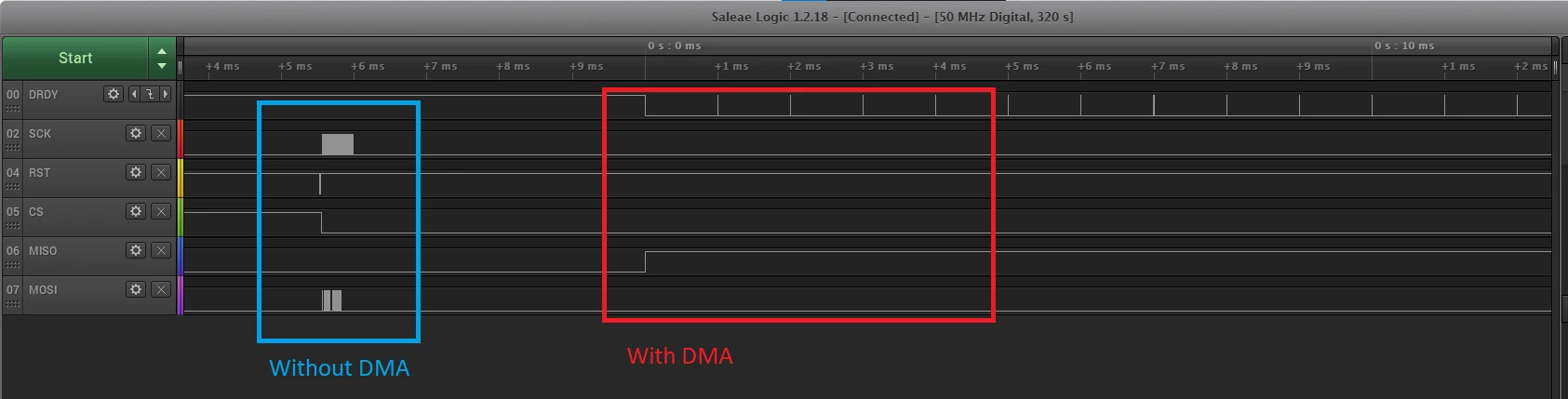

When I use DMA with SPI it is not working.
0693W000007BGY9QAO.pngWhen I get a falling edge on DRDY this function gets called :
void HAL_GPIO_EXTI_Callback(uint16_t GPIO_Pin)
	if(GPIO_Pin == DRDY_ADC_Pin)
		HAL_SPI_Receive_DMA(&hspi1, SPI1_RxBuffer, READBACK_LENGTH);
SPI1 RX Buffer is located in a DMA accessible memory, RAM D2 (it works I checked the .map) :
uint8_t __attribute__(( section(".ramd2section"))) SPI1_RxBuffer[READBACK_LENGTH]; // SPI Tx
My question is do I need to use a setup function outside of what HAL_SPI_MspInit() already does. For example HAL_MDMA_Start_IT() ?
I've red few posts with the same problem but the solution is never explicated or done not using only HAL function.
What I use :
SPI1 Master full-duplex
DMA1 Stream 2 SPI1_Rx to SPI1_RxBuffer
MDMA Stream 0 SPI1_RxBuffer to ads_buf located in DTCMRAM
11 replies

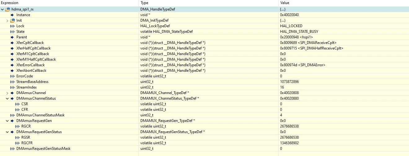

Gabriel T
Gabriel TAuthor
Senior
January 14, 2021
The SPI is always in "HAL_SPI_STATE_BUSY_RX"
I got this with debugging tool for the DMA Handler
waclawek.jan
January 14, 2021
I mean the SPI and DMA peripherals (and, once you've mentioned, relevant DMAMUX) registers.

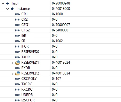

Gabriel T
Gabriel TAuthor
Senior
January 15, 2021
Sorry, I get it now. I looked register value with debugger tool at the end of the init function:
SP1 :
CR1 = 0x 0000 1000
CR2 = 0
CFG1 = 0x 7000 0007
CFG2 = 0x 0540 0000
IER = 0
SR = 0x 0000 1002
IFCR = 0
TXDR = 0
RXDR = 0
UDRDR = 0
I2SCFGR = 0
I got it from this :
0693W000007BPJmQAO.pngHere is what i got for DMA :
// DMA
CR = 0x 0000 0400
FCR = 0x 0000 0020
// DMAMUX
CR = 0x 0000 0025
Do you think I should stop using Cube and just go with the datasheet ?
Thank you,
Gabriel

But the chronogram is still the exact same I posted before
waclawek.jan
January 15, 2021
This appears to be much more complicated than I thought. I don't use the H7 and I realized that the SPI in there is much more different from other STM32 than I thought, and I don't understand how Rx-only on this SPI is supposed to work. It appears to me that there's no such mode in this SPI.
In other STM32, once you set Rx-only mode and set SPE, it automatically starts to generate clocks. Here, it appears, that you are supposed to Tx to be able to generate clocks.
Gabriel T
Gabriel TAuthor
Senior
January 18, 2021
Yes when I use it without DMA, It sends "dummy" data in order to receive. The Tx buffer ptr is the same as the Rx one so it echoes the message
