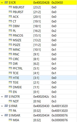

When using DMA to do a SPI transmit, I found a strange behavior. The problem is, that the communication to the DAC works for a few seconds, depending on the used frequency. After the few seconds only 1 byte instead of 3 bytes are sent and the NSS Pin (Hardware regulated) stays low. You can even see these two data items to transfer in S1NDTR (NDT). I used the approximately same code with Software NSS without any problem.

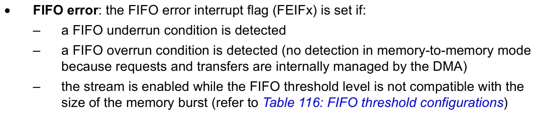

I also get a DMA FIFO Error (FEIF) directly after starting the DMA stream, even when using DMA circular mode. Not every time but over 50% of the times when the communication is working I get the FEIF. When the communication is not working anymore, I do not get the FEIF anymore.

> But in your screenshot, NDTR=3, so 0 bytes have been sent, not 1.
You are right, the screenshot was not made at a good breakpoint. For other people having this issue was the case that only 1 byte have been sent and 2 bytes were still in queue.

I have also attached the values of the DMA2 Stream1 register at the moment my communication breaks (first transfer_error).

> 169: Dma.SPI1_TX.1.FIFOMode=DMA_FIFOMODE_DISABLE
You're not using the FIFO, so the FEIF flag is irrelevant here. Not the cause of a problem.
Your DMA stream is disabled, so that's why the SPI isn't clocking in new data. As for why, I'm sure it's a code bug but I don't think it's within the code presented. If things break consistently, should be able to debug and hit pause when it's "broken" and examine why. In the case of what you've presented, it's because DMA stream isn't enabled.
I don't see code where TSIZE is set, so probably EOT isn't happening.
