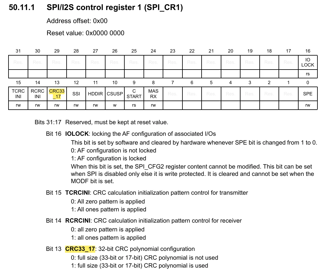

Hello, I am having an issue implementing a 32 bit CRC 0x04CDB117
I am quite confused by the documentation on how to set the a 32 bit CRC
I don't understand section 53.5.3 on the most significant bit in in CRCPOLY must be larger than the data size.
I don't understand what register CRC33-17 is referring to.
Any help or clarification would be appreciated.
Thanks
TDKBest answer
Jul 14, 2025 9:06 PM UTC
If you have a 32-bit CRC, set CRCPOLY register to 0x04CDB117 and set CRC33_17 bit in the CR1 register.

The patterns typically take the for x^32 + .. + 1, which is arguably 33-bit, in other implementations this is implied, or hidden in the hardware.
The CRC33_17 seems to relate to how it's managing the HW, and potentially 16-bit writes to the data register, and interstaging values between bytes/words.

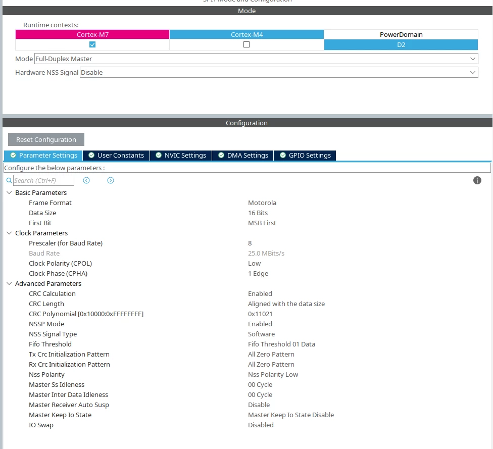

I have a working implementation with 16 bit frame length and I am trying to go to 32 bit length.
I thought it would be as simple as increasing the DMA from halfword -> word and changing the CRC to be 32 bit but I am running into CRC errors still so I assume my 16 bit implementation is more fragile than I expected.
Just communicating from one STM32H755 -> STM32H742
Transaction is just a blob of 128bytes full duplex
These are my working 16 bit settings

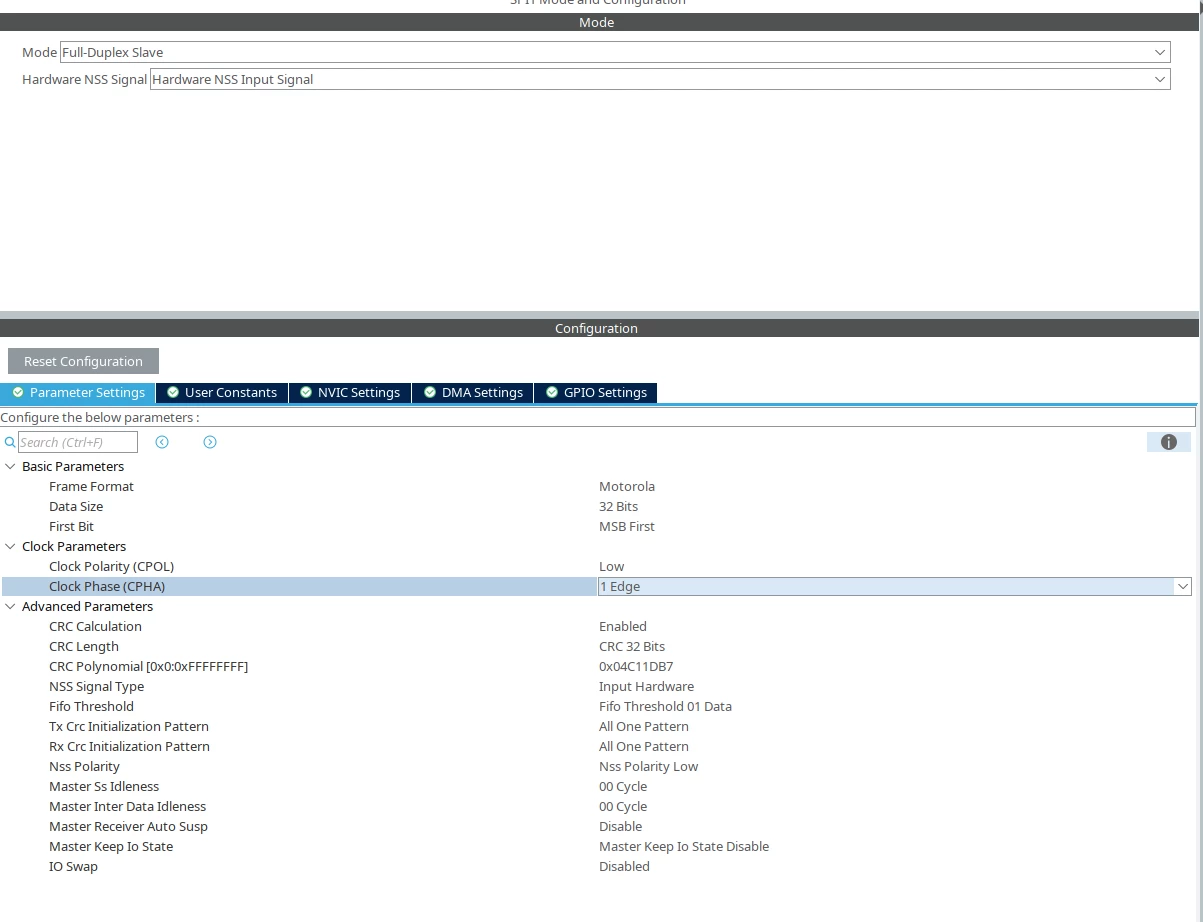

This is my 32 bit implementation which I think is correct based on the initial reply and my issue lies in my implementation and perhaps transmission lengths, still investigating. Thanks
Jul 14, 2025 10:45 PM UTC
Could be an endian-ness issue and/or interpretation issue.
Perhaps try it on 4 bytes of data which can easily be verified through one of the online CRC calculators.
Show what data you're calculating it on, what you get, and what you expect.
