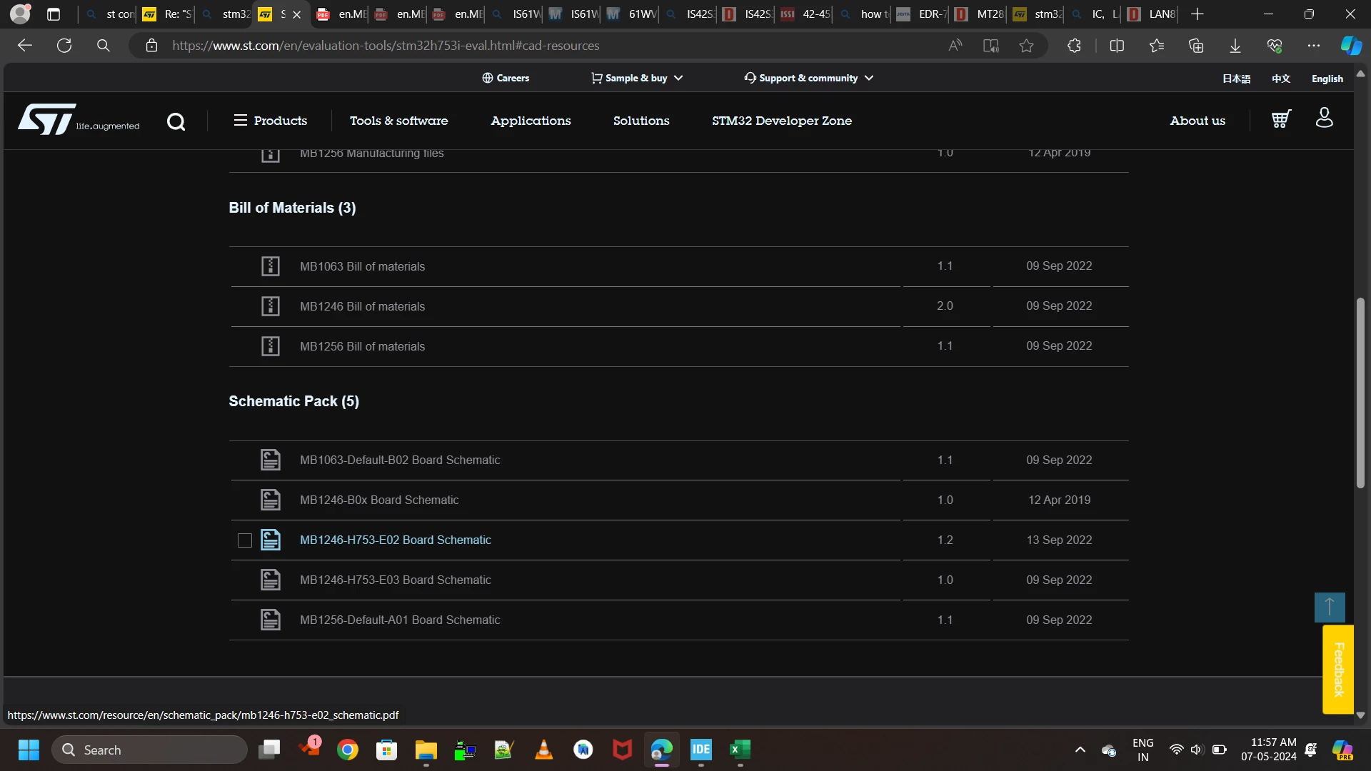

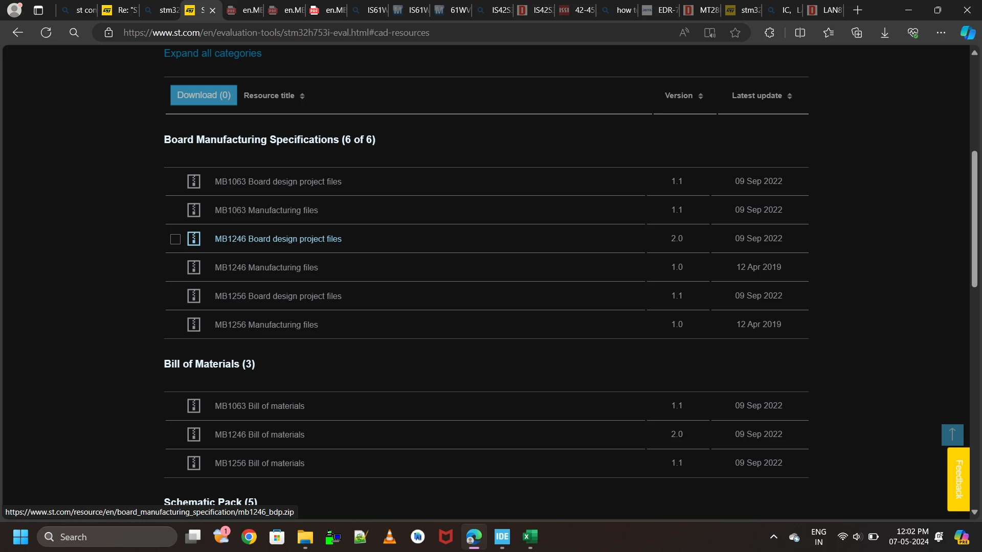

Hi, thanks for the important NOTE. After discussing with the vendor, it appears that the BGA with a 0.8mm pitch of the STM32H743XIH6 can indeed be used to manufacture a prototype of 5 pieces for testing purposes. This decision is quite beneficial as it reduces the risk of errors in foot printing or other potential mistakes, which is crucial for our first board to function like the evl-brd. I received instructions from the senior to keep the same board and package of the BGA itself, but to remove any unnecessary components. This should prevent any issues. We are implementing only the memory section, OTG_HS_USB, Ethernet, JTAG port for debugging, LTDC, and QSPI, which are already present. This should make the process relatively easy.so, if we follow same package as it is , then, its fine?
Regarding the STM32H743, since it is NRND (Not Recommended for New Designs), should I opt for the STM32H753I-EVAL, which is active? If so, it seems that mp1246-h753-E02 is the latest version 1.2, but E03 is version 1.0? Which version should be considered for the MP1246-board design file, version 2.0 dated September 9, 2022
