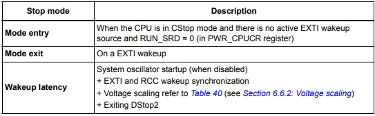

2) Check the table in your product ref man for mode exit:
0693W00000aI9VDQA0.pngYou may also need to read the Low power mode paragraph in ref man.
Hope that helps a bit!
