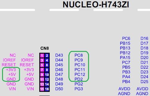

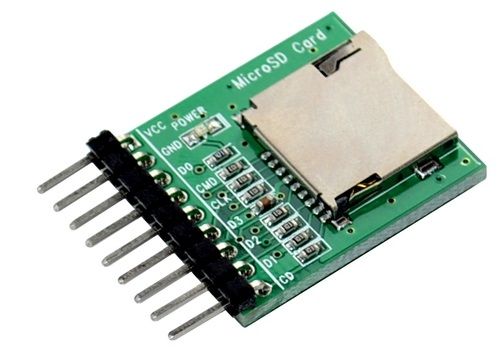

Tesla DeLorean
Guru
February 13, 2018
Posted on February 13, 2018 at 17:29
Not ready suggests you have code in there looking for the socket's Card Detect pin.
Should be trivially easy to wire a full 4-bit SDIO from a NUCLEO-144, along with a GPIO for Card Detect
3V3 Socket socket here
VCC - 3V3
GND - GND
D0 - PC8
CMD - PD2
CLK - PC12
D3 - PC11
D2 - PC10
D1 - PC9
CD - GPIO PG2 or PG3 close
