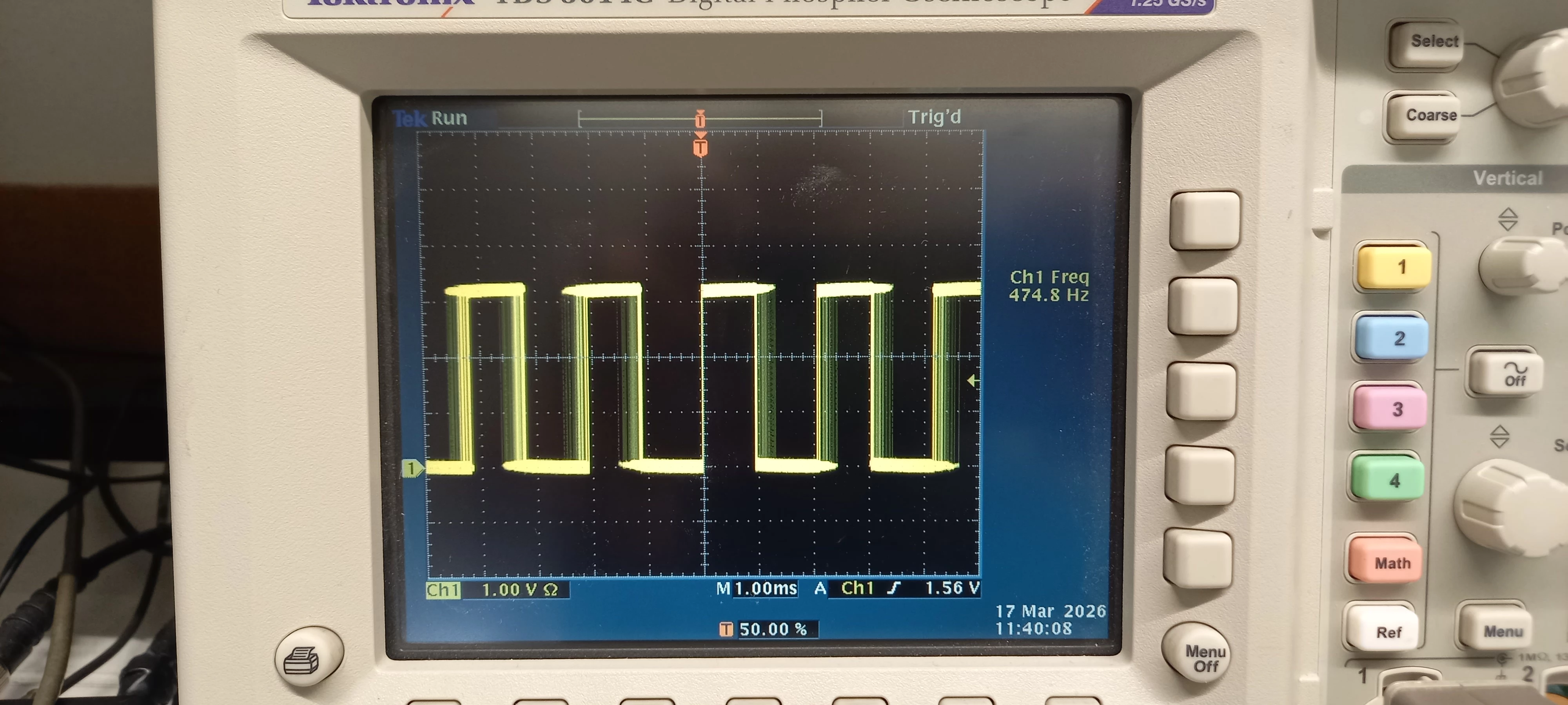

in our design with STM32H753ZIT6 I've adjusted the C0G load capacitors on the LSE 32.768 kHz crystal so that the real-time clock is now very accurate (less than 1 second error in 24 hours). I've always performed the calibration in VBAT mode at a voltage between 2.3 and 3.2 V.
However, now I've noticed that in normal VDD mode with active controller, the real-time clock is running significantly too slow, with an error of 90 seconds in 24 hours. I've ruled out the VBAT supply voltage as the cause. Any ideas what could be causing this large error in normal VDD mode?

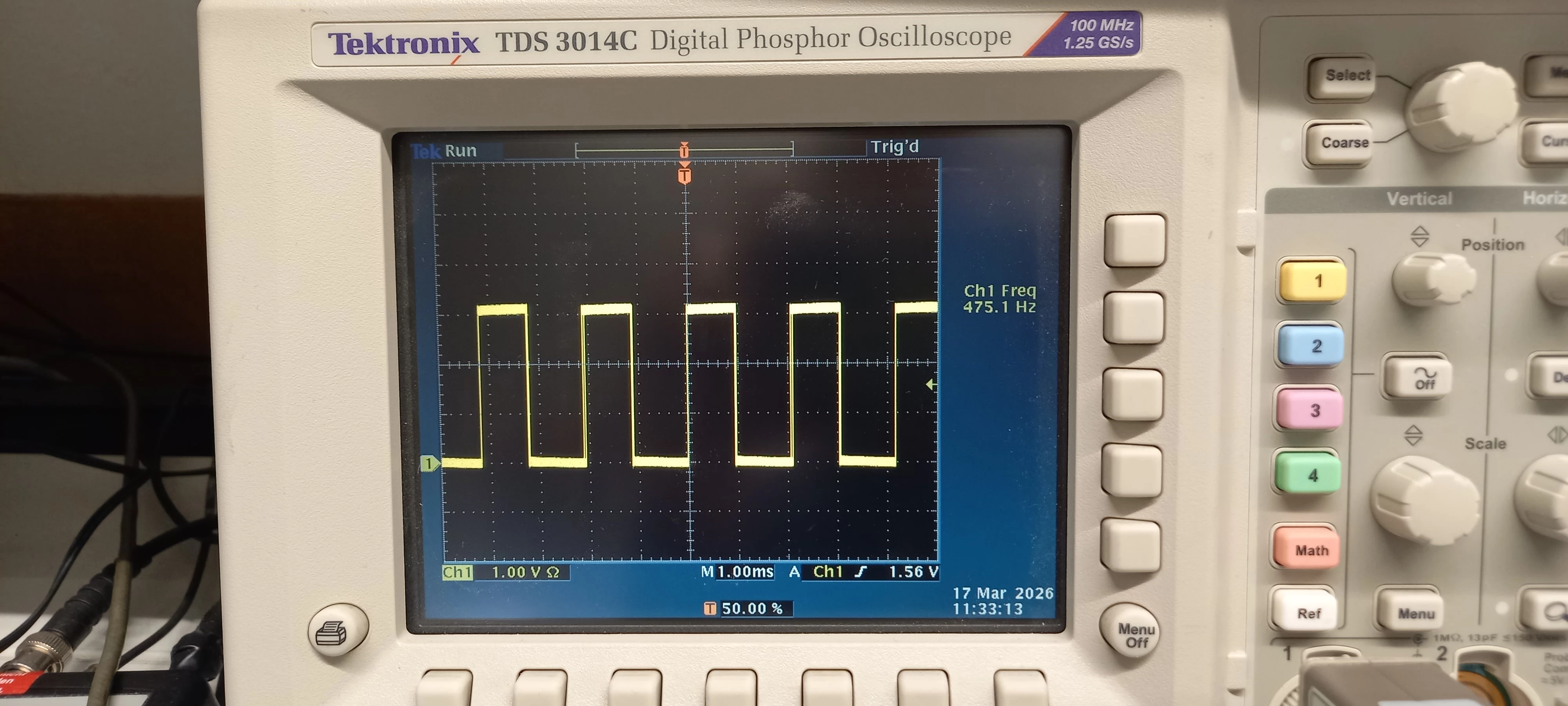

I did the test with the calibration signal at PC13.
Here is the signal in VBAT mode. (I turned the persistence of the scope to infinity.) The edged are very stable at the same position.
And here the signal in normal running mode, again with infinity persistence:
There is a significant jitter. If I stop the CPU with the debugger, the frequency is stable again.
I have no explanation, why the frequency is not 512 Hz.
I changed the setting for the drive strength to medium-low and to medium-high (regarding the errata). With both setting I can achieve a stable frequency (of 512 HZ! ?:-/) in battery and powered-up mode. I decided to use the real medium-high mode and I'm performing a long-term measurement now. I hope this solves my issue.
