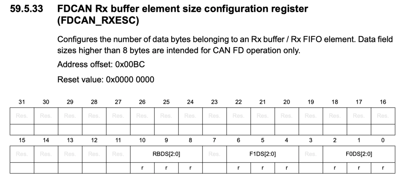

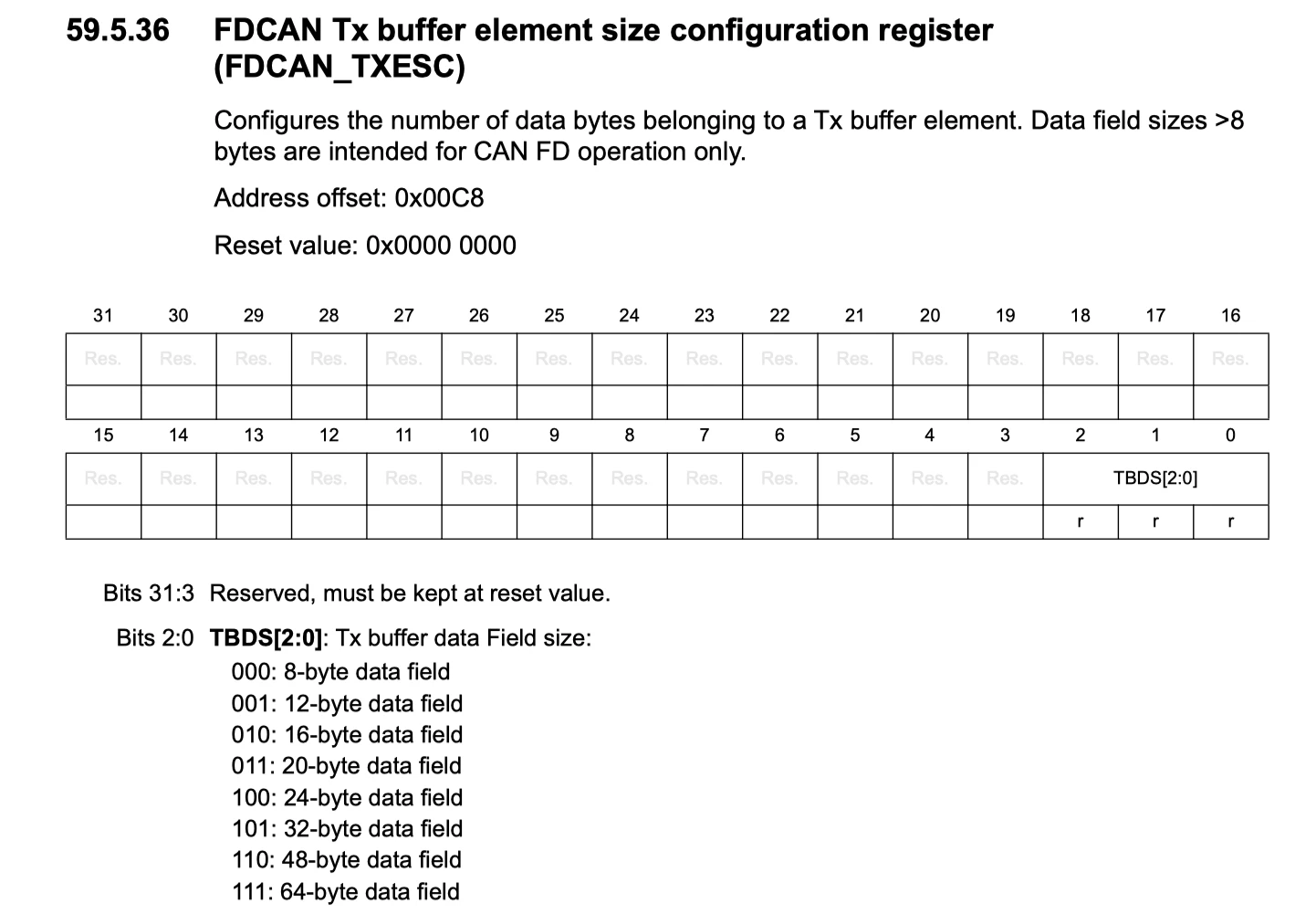

STM32H7 RM0399 Rev4 FDCAN Typos?
Looks to me like the FDCAN peripheral has a few registers that are marked 'r' when they are likely 'rw' in the RM. They are the registers that configure the size of the FDCAN messages. This isn't blocking my work; only thought the ST team should know so they can fix it if it is indeed a typo.

Hello @steezeman ,
Welcome to the community and thank you for raising this issue.
I will escalate this issue internally to be fixed in the coming revisions of the RM.
Thanks again.
Internal Ticket 174976 for internal follow-up (not accessible by the community users).
