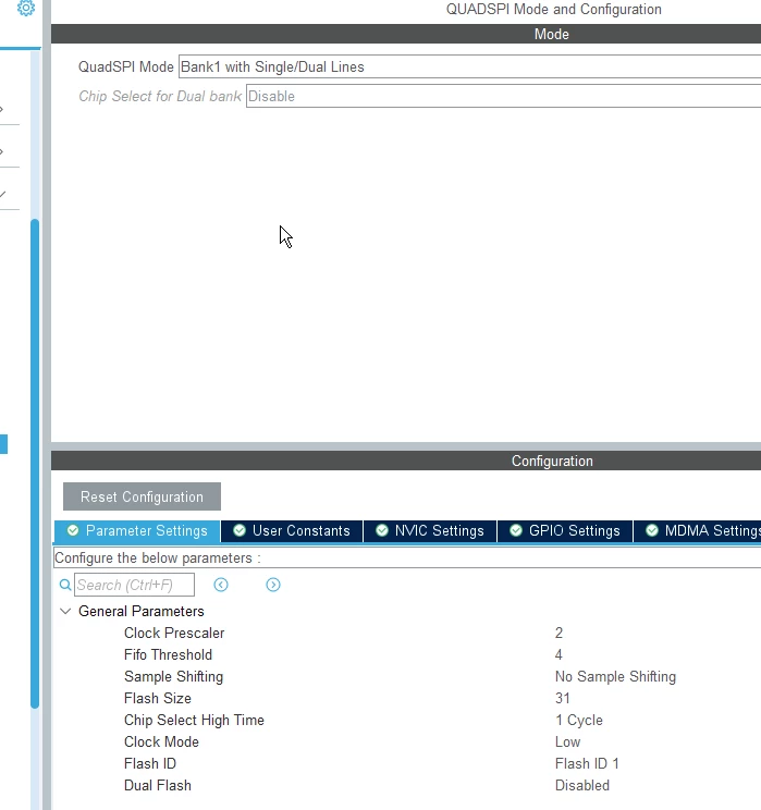

Apr 4, 2024 3:19 PM UTC
In main the two functions HAL_QSPI_Command(....) are working, I see clock and output data with oscilloscope, the
HAL_QSPI_Trasmit_IT (...) is made but I don't see the data and clock in output. My goal is to use only the HAL_QSPI_Trasmit_IT (...) for send 4byte to external DAC.

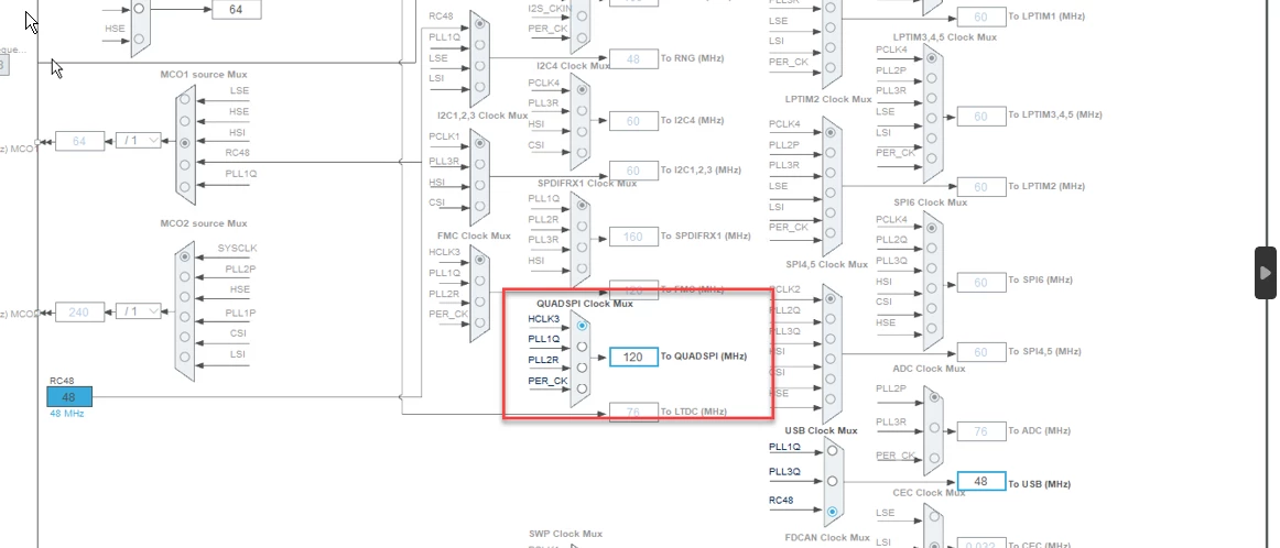

static void MX_QUADSPI_Init(void)
{/* QUADSPI parameter configuration*/
hqspi.Instance = QUADSPI;
hqspi.Init.ClockPrescaler = 2;
hqspi.Init.FifoThreshold = 4;
hqspi.Init.SampleShifting = QSPI_SAMPLE_SHIFTING_NONE;
hqspi.Init.FlashSize = 31;
hqspi.Init.ChipSelectHighTime = QSPI_CS_HIGH_TIME_1_CYCLE;
hqspi.Init.ClockMode = QSPI_CLOCK_MODE_0;
hqspi.Init.FlashID = QSPI_FLASH_ID_1;
hqspi.Init.DualFlash = QSPI_DUALFLASH_DISABLE;
if (HAL_QSPI_Init(&hqspi) != HAL_OK)
Error_Handler();

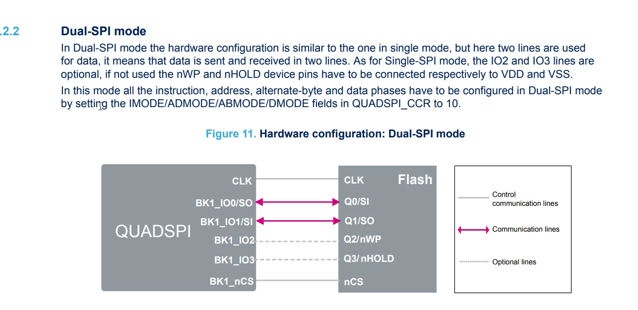

On a hardware level, it seems possible:
