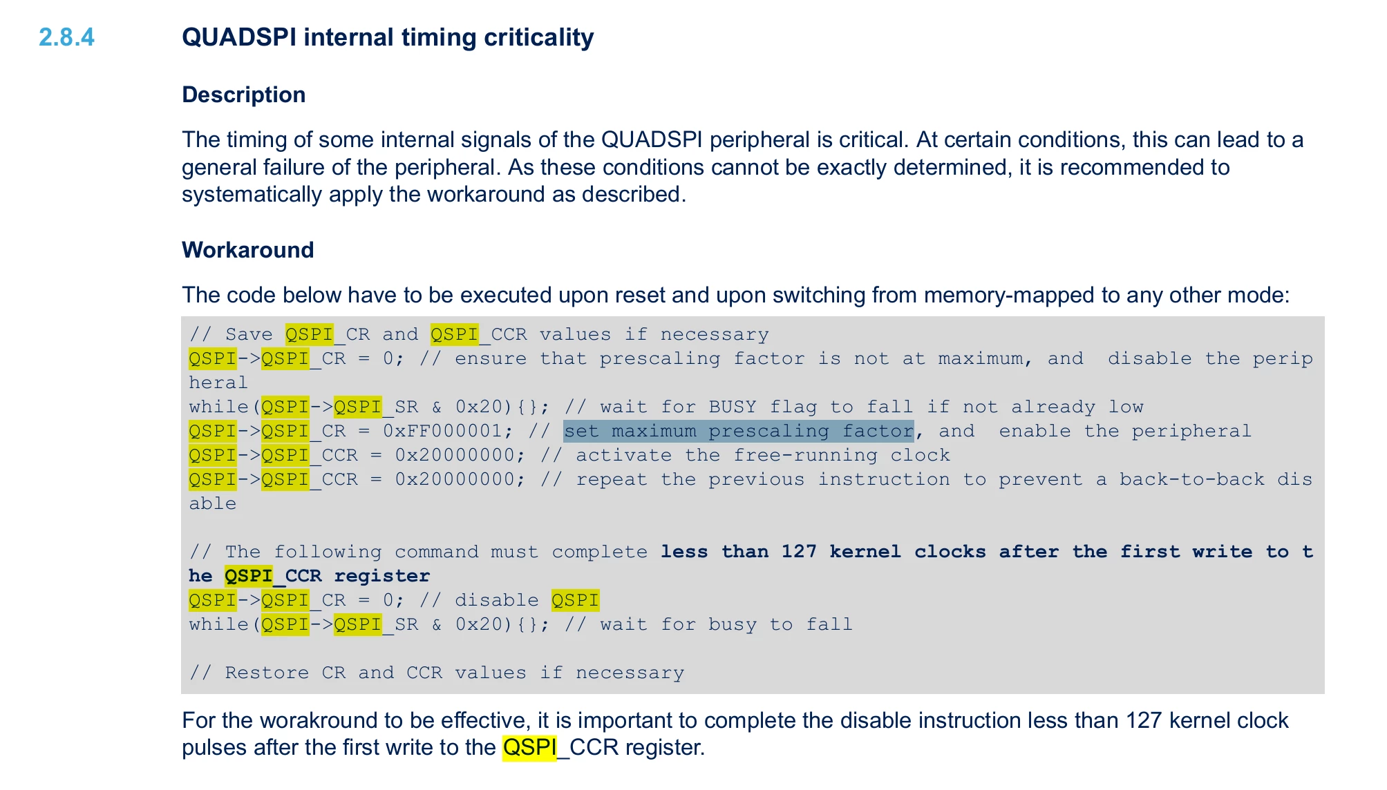

Hi, we see STM32H7 has Qspi errata as below:
But we are not sure where to apply the patch exactly. It says "upon reset and upon switching from memory-mapped", mean in reset function, right after or before "HAL_QSPI_Init"?

Good Question.
I'd think prior to HAL_QSPI_Init(), but after the APB ENA / RST for the peripheral/clocks. And apparently after a bus abort.
Reading between the lines here, and looking at the prescaler changes, I would suppose there's some synchronous circuitry in there that doesn't take an async reset, or short clock count synchronous reset. ie in a slower domain, engaged inopportunely
Say you're running the QSPI device at 25 MHz, via the prescaler, but hold the reset for a couple of 200 or 400 MHz cycles.

Hello @Dat Tran ,
Edit:
As mentioned by @Tesla DeLorean the workaround is used after enabling peripherals/clocks and before HAL_QSPI_Init().
Also this workaround is applied when switching from memory mapped to any other modes.

Dat Tran
Dat TranAuthor
Senior II
April 26, 2024
Following @KDJEM.1 : "before enabling peripheral clock and after HAL_QSPI_Init()."
Following @Tesla DeLorean : "prior to HAL_QSPI_Init(), but after the APB ENA / RST for the peripheral/clocks"
Following the ST HAL Driver: enabling peripheral clock is inside HAL_QSPI_Init()
HAL_StatusTypeDef HAL_QSPI_Init(QSPI_HandleTypeDef *hqspi)
//.... ST code
Question: Apply workaround here????
/* Enable the QSPI peripheral */
__HAL_QSPI_ENABLE(hqspi);
or Apply workaround here????
// ... ST Code
return status;
so I am still confused, could you please point out a bit more clear?

Hello @Dat Tran ,
I apologize for this typo and this confusion "The workaround is used before HAL_QSPI_Init(). " as explain by @Tesla DeLorean
