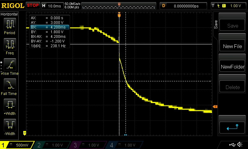

VDD and VDDA are on the same power bus, and it takes approximately 4.2ms to drop from 3V to 1.8V (I'm running 160Mhz clock, so 4ms should be enough to move a GPIO).

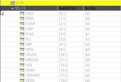

Read out and check/post content of PWR_CR.

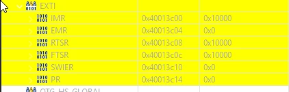

1) contents of PWR_CR and EXTI registers seems correct.

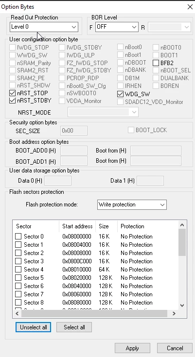

3) Brownout is disabled

I've tried also using regulated power supply (3v3). It seems that CPU is resetting almost immediatly as voltage drop down to 3V: shouldn't be 1V8?

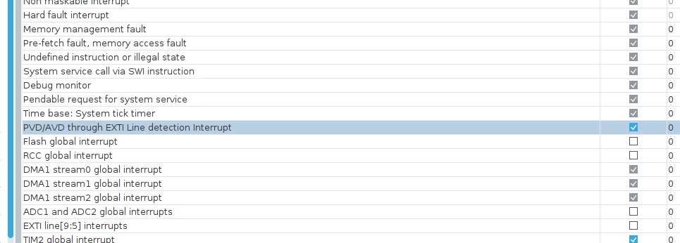

Is there any tutorial on PVD? I looked for one but I could not find. I am using a STM32H7. I enabled PVD on the .ioc file.
