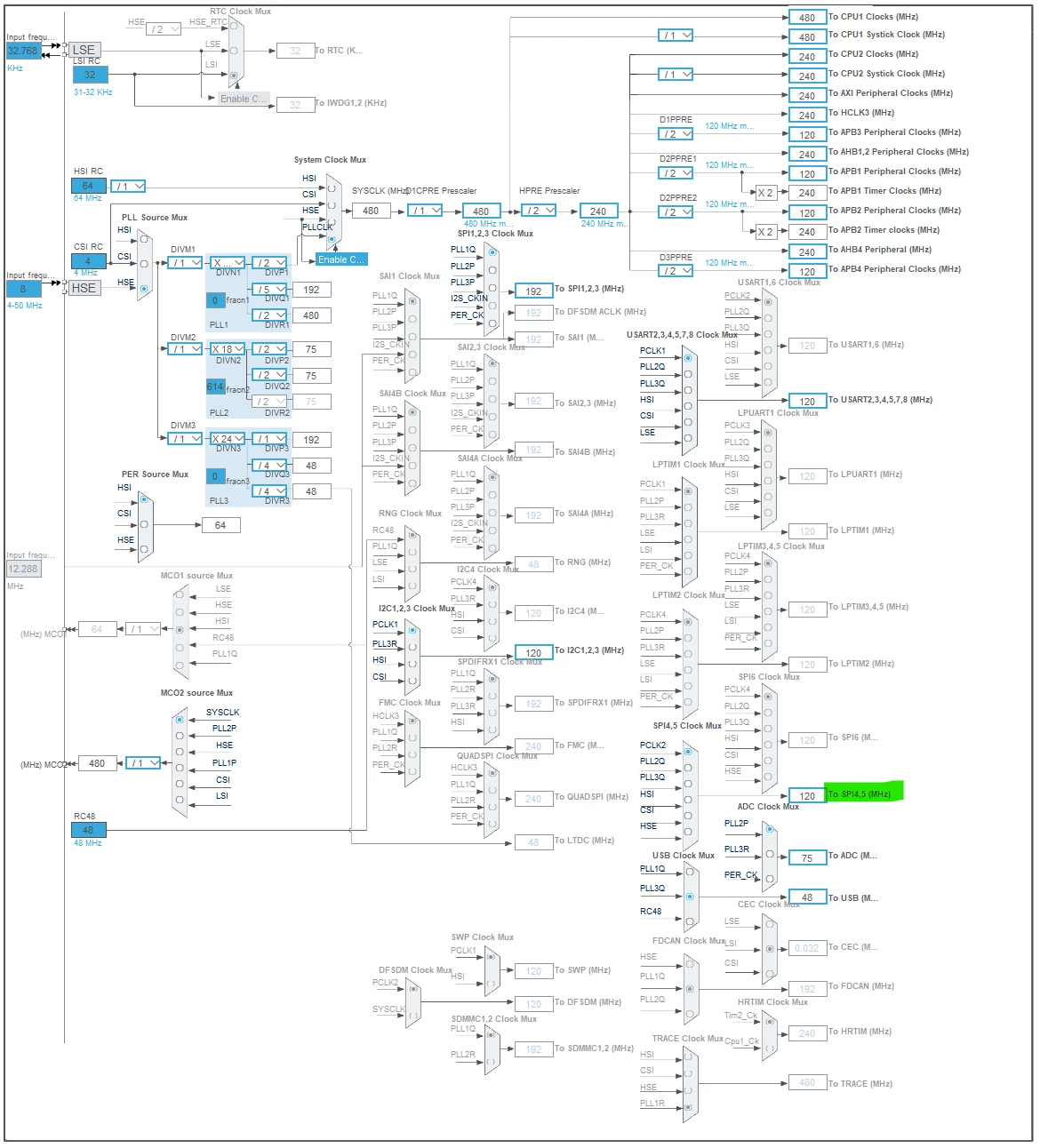

MSZBAuthor
Jan 16, 2024 2:46 PM UTC
HSE is used, 8 MHz MCO from ST-LINK. It's jitter is roughly 1 ns.
The jitter of the TIM12 output, which triggers the DMA, is ca. 40 ns (!). Maybe I'll have too look at the supply configuration in more detail. The board runs in Supply Config  3 (Internal SMPS and LDO cascaded).
Thats the clock configuration:
