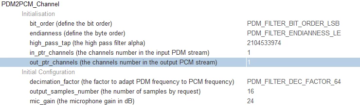

I am using the STM32CubeIde to initialize it and everything, so all of that is there. I have it set to 1 channel input and output since I am testing only one mic at the moment.

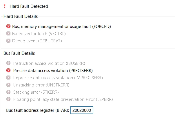

So when I run the code, it get a hard fault when I enter the PDM_Filter function. It gives me a hard fault.
I've tried changing the buffers, pcm/pdm arrays size. I also tried changing them to int16_t and uin16_t. I've looked at other examples. The library seems pretty simple to use, but I'm just stuck on what could be wrong. Are there any verified examples?
TDKBest answer
May 6, 2021 9:45 PM UTC
Seems like you are overrunning the bounds of an array. 0x20020000 is the end of the DTCM, which is where pdmData/pcmData probably exist. How many samples are you processing in each call.

CFran.1
CFran.1Author
May 6, 2021 11:08 PM UTC
0693W00000ANbl0QAD.pngIt should only be processing a byte of PDM information and outputting a 16-bit PCM signal at a time, unless I am misreading the application's note.
