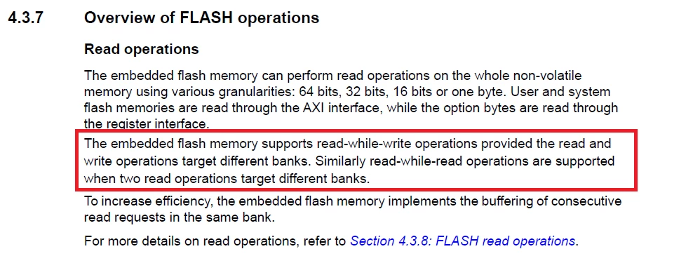

I was curious how long all the operations take, using the SysTick - no problems for all operations, except when internal flash was erased or programmed...
Maybe you need to relocate the vector table and the code in the RAM while doing this operation.
Although it makes absolutely sense, but where can I find this info in the H73x RM0468 ?
There is no read-while-write operation support on H723 like in H743:
H743 (RM0433) :
