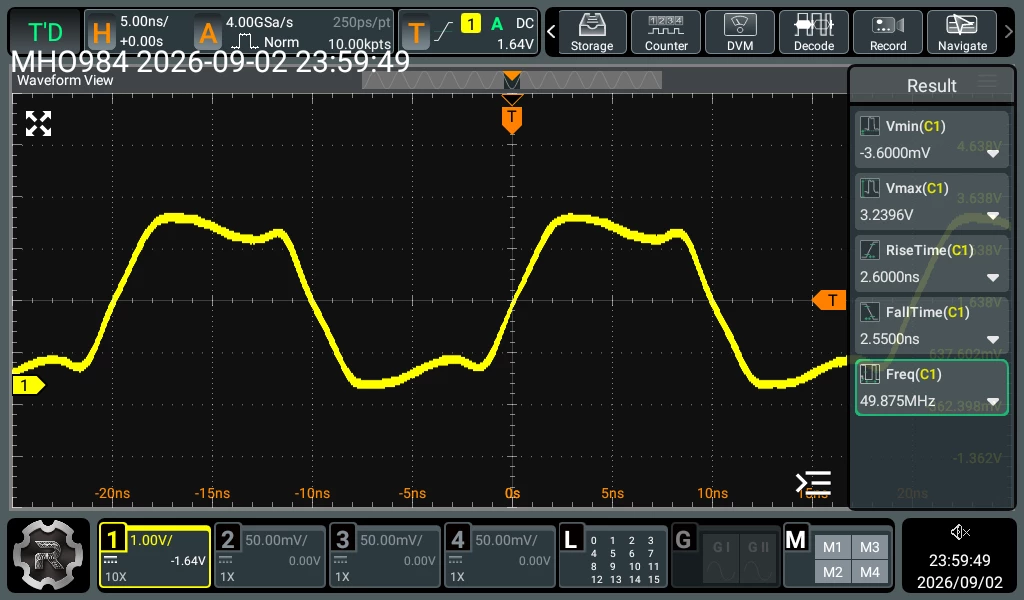

I have a custom board using STM32H735ZGT6 and the LAN8742 Ethernet PHY using RMII. During the execution of CubeMX generated Ethernet initialization code, the MAC software reset bit is not cleared triggering an error. I have read a lot of forum posts about this issue and have verified the following:
  • The RMII reference clock is supplied by the PHY using a 25MHz crystal as in the H723 nucleo board. The 50MHz clock generated by the PHY is present at PA1 pin and verified with an oscilloscope. (see osci image below)
  • VDDCR voltage is 1.2V generated by internal regulator on PHY
  • The PHY hardware reset is supplied by a MCU GPIO, and the resistor straps seem to function properly during reset (probed all with oscilloscope). I also have a pulldown resistor on the LED2 pin so that REFCLKO is generated by PHY.
  • I can communicate through MDIO with the PHY to read out and write to registers, confirming that straps work ok.
  • The output side of the PHY works, a link is established in both 10 and 100Mbps mode.
  • The standard CubeMX ethernet initialization is used meaning the MAC, TX, RX clocks are enabled, GPIOs are set to AF11 very high frequency mode, MAC RMII is enabled
    • the clock settings and RMII enabled is verified by reading out the PMCR and AHB1ENR registers
Does anybody have an idea what the issue could be? The clock signal quality looks good enough to me but can somebody weigh in on it? I also have the MCU core clocked to 192MHz and VOS1 is used on the LDO, does the power and frequency setup have any bearing on the MAC? Should i be thinking about silicon GPIO damage at this stage?
I am attaching the oscilloscope image of the RMII clock (probed with a long ground lead and 10x probe, so the signal is probably worse than it actually is) as well as the PHY schematic.

R48 MDIO is a low value? An MCU port should drive it without a PU.
/RST can be the MCU NRST.
C77 and C76 are high for a 25MHz crystal (is it starting soon enough?).
The pull down resistors R51 and R52 mean something at start-up, I think only LED2 pin 2 should be pulled down.

Thanks for the answer,
All reference schematics i have seen has 1.5Kohm pull-up on MDIO. The MDIO interface also works properly as mentioned so I doubt that is the problem.
I have a jumper to switch /RST to the MCU RST, however i already issue a reset by GPIO to the PHY in my init code which seems to work properly.
The crystal has 8pF load capacitance as opposed to the nucleo board which has 4pF, thats why the caps are larger, I will try with lower values and see if that has any effect.
You are right LED1 doesn’t need a pull-down, as it already has an internal pull down but I also don’t think that has any bearing on the problem.

maybe the Ethernet initialization code is running before the LAN8742 can accept the command, maybe the first command sent to the LAN8742 is being lost because of initial conditions ?   you could try delaying sending the software reset or send some “dummy” commands first ?
