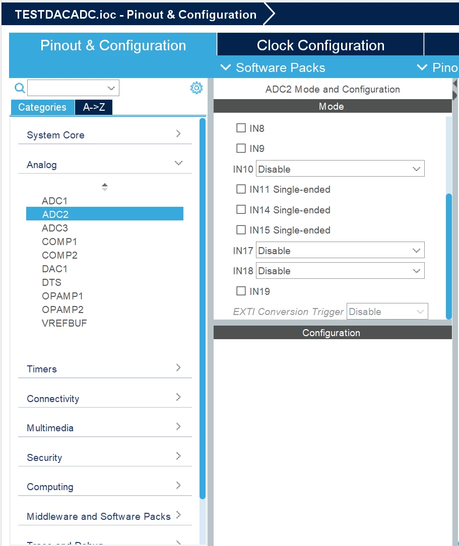

3) Finish the configuration of the project. Accept the default configuration.
Now we can see that ADC2 IN16 is missing.

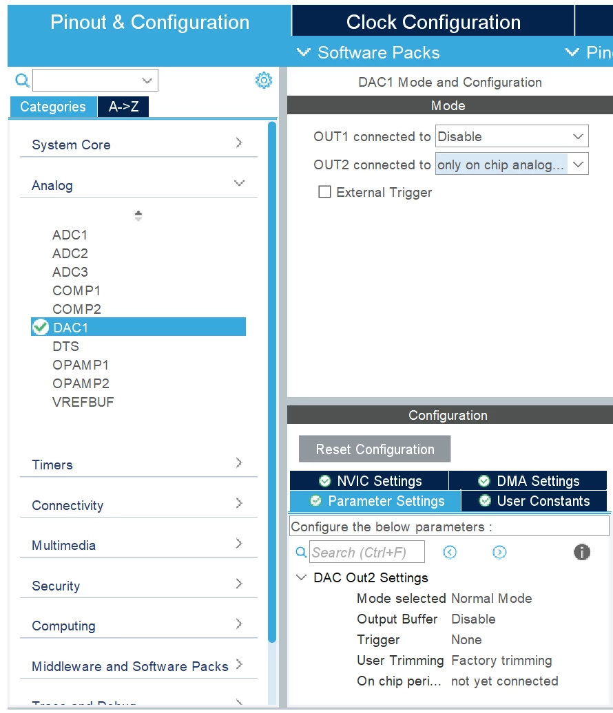

4) Set up the DAC1_OUT2 to peripherals:

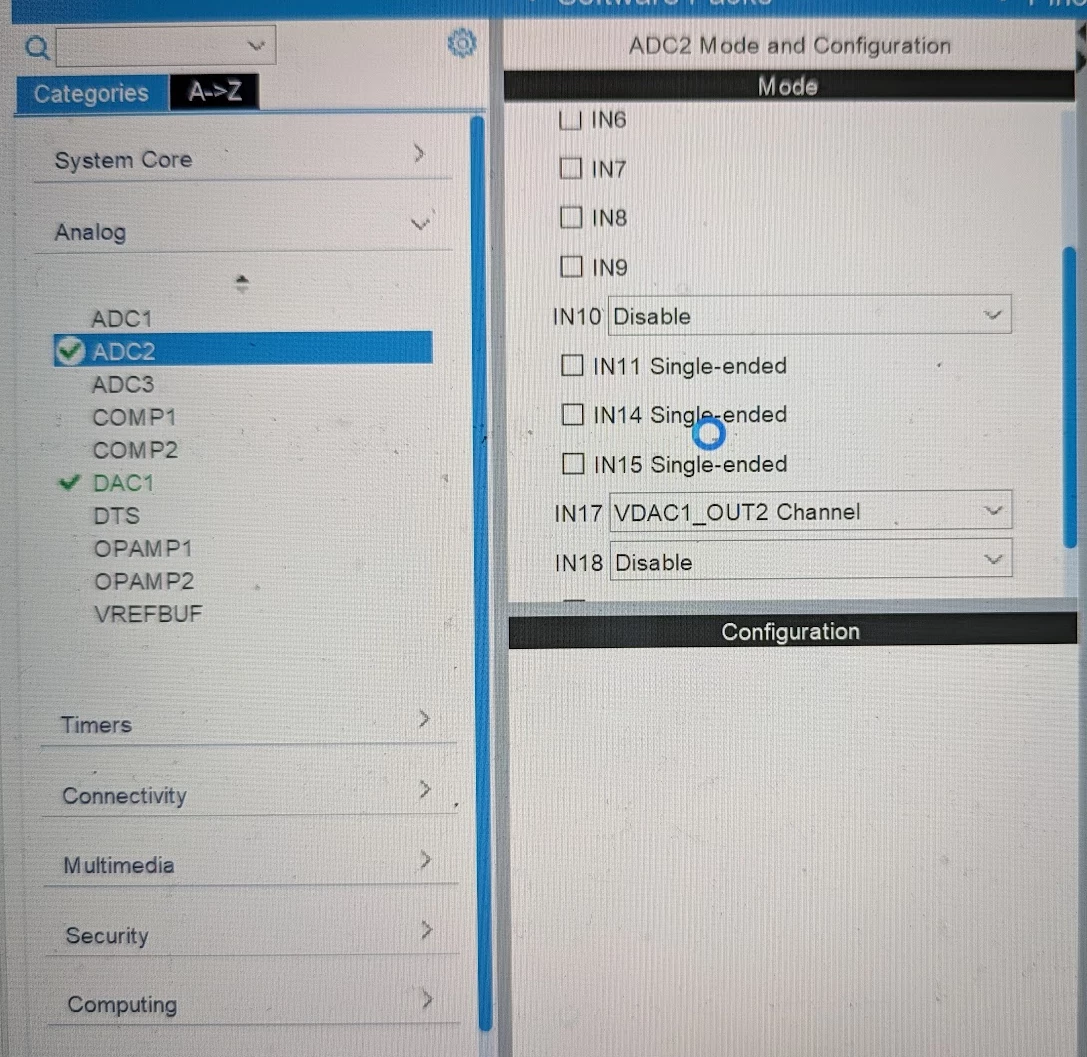

5) Setting the ADC2 IN17 leading to infinite loading:
Saving the ioc file now break the application as you cannot do anything anymore.

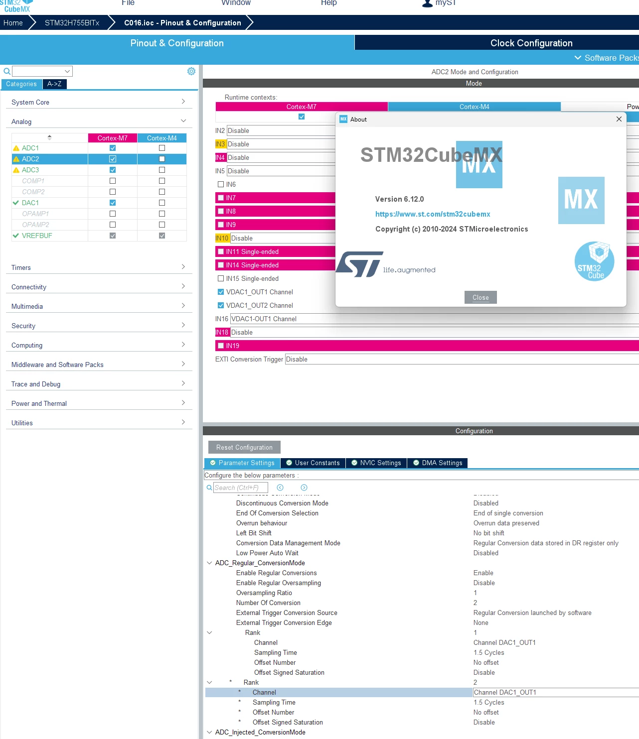

Jul 29, 2024 11:16 PM UTC
In CubeMX 6.12.0 for STM32H755BITx, I can not select DAC1_OUT2 to be monitored by ADC IN17.  IN17 is not available for section - CubeMX skips from IN16 to IN18.
