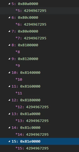

STM32H7 Internal Flash Error
I'm having trouble reading/writing to internal flash on an STM32H743XI. For a while I've been erasing/programming sectors of internal flash from a custom bootloader without issue but I somehow got the chip into a state now where 4 sectors can no longer be read from and instead trigger a hardfault. I think it has to do with ECC but I'm having trouble verifying that or clearing the error. The issue persists through power cycle. The HAL functions for erasing/programming flash still execute on these bad sectors and return HAL_OK but if I try to read data anywhere in these sectors the MCU hardfaults.
Anyone have an idea of what the issue is and how to resolve it?
Debugger is also unable to access this memory as shown below:

If there's an ECC error, this would probably affect only several 8-byte blocks, not entire sectors (if they were not overwritten without previous erasure). Did you check this?
I guess PCROP was engaged accidentally for these sectors, that would cause the very symptoms you described.

Fixed it for now with a full chip erase, but still haven't found what triggered it. Do you know if PCROP protected sections result in bus faults when a debugger is attached? Based on the reference manual it seems like PCROP sections should return 0x00 for data fetches.

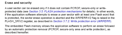

From RM0433 section 3.3.10
If you rush to recover by erasing (with protection removal) you'll not learn the cause.
At least connect using e.g. STM32CubeProgrammer and check the option bytes first.
