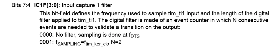

As @AScha.3 already mentioned, this lag could be primarily driven by the filter value set in the CCMR1 register.
Incorrect filter values can cause a delay in the input capture measurement, you can manually modify the register to set the correct bit.
Please note that this might not be the only factor (configuration of the timer, the clock speed,.. )

My CR1 value is 129 and my CCMR1 value so I think it should be sampling at 240MHz and not applying filtering. I can try to increase the rate to 480 MHz to see if it halves.

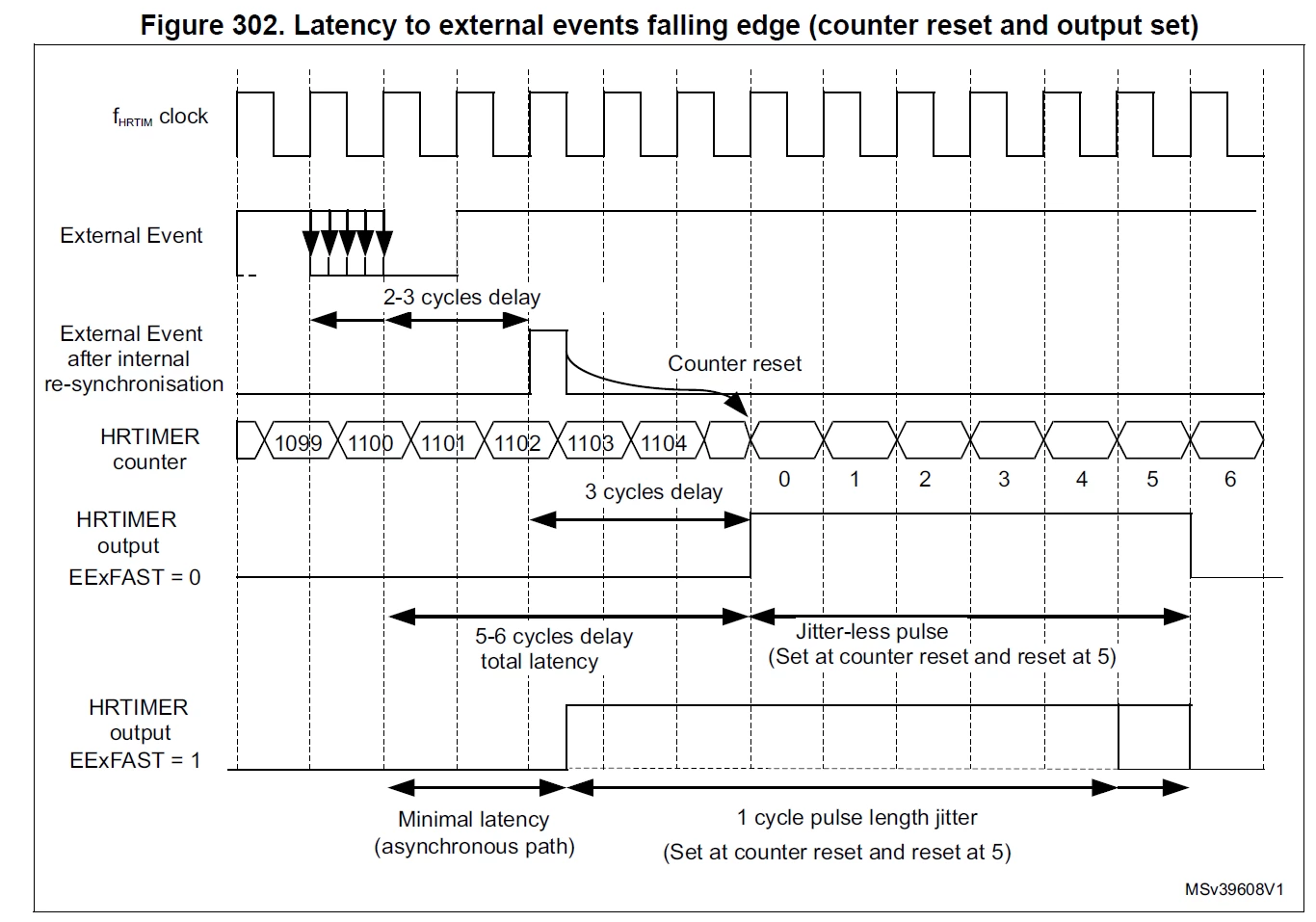

There is a resynchronizer circuit on the input figure 2 - 3 flop-flops in a chain.
It's going to add delay, and behave like a nyquist sampler.
I think it's off the TIMCLK, 120 MHz ?

That tracks with the delay, but is that a limitation of the H7 package? To maybe reset here...should I be using the HRTIM instead for something I want to capture as accurately as possible? Just saw in the clock tree that everywhere else 240 MHz is the max except for feeding HRTIM.
Sorry I'm a stm newb and still working my way through the docs and TIM was a bit more accessible to begin with. Should I migrate to HRTIM?
TkmnAuthor
January 27, 2024
Looking through the HRTIM section and I don't currently think it is that attractive compared to standard timer right now due to the limitation in period counts. However, it does seem that the delay is documented in the external event section of HRTIM as 2-3 cycles of internal re-synchronization and then a 3 cycle delay on the output totally 5-6 cycles of latency.
I assume the same holds for the standard timers. So my 7-8 cycle offset seems to be ultimately attributable to a combination of GPIO speed and this delay. Going from LOW to FAST/VERY FAST GPIO speed on output compare reduced the count offset to 5, which is explainable by the ~2 + 3 slip documented for HRTIM.
But understanding that also means I think I can safely adjust it out. Thanks all!

Another remark is, that you cannot distinguish latency of the output (i.e. delay due to circuitry between the comparator and actual output, which e.g. in case of timers with complementary-outputs-and-break (such as TIM1) may IMO be more substantial than in timers without that) from latency of the input. They add up.
