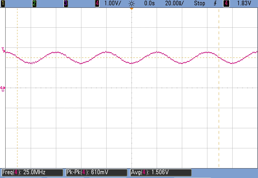

Hello I have a custom board with a STM32H753ZIT and I’m wondering about the amplitude of the HSE crystal. It is only 300mV (see the attached Image). It seems to wok but is this normal?
The crystal requires a load capacity of 20pF per datasheet, the caps on the board are 27p so this should be OK. (27pF/2+5..10pF)

    Which pin, HSE output or input?
    The crystal oscillator is basically an analog circuit, and also a low power one. It may quite well work at this level, and also you may be loading it by your oscilloscope probe, lowering the amplitude further.

    UI read 300mV on pin 23 RCC_OSC_IN , 220mV on pin 24 RCC_OSC_OUT
    It is a 10Meg probe with 15pF. I also tried to take capacity into account but without significant difference.
    We are using the same type of crystal for the Phy and there is around 750mV.

    If in doubts whether you are in a safe area, try to review AN2867.
