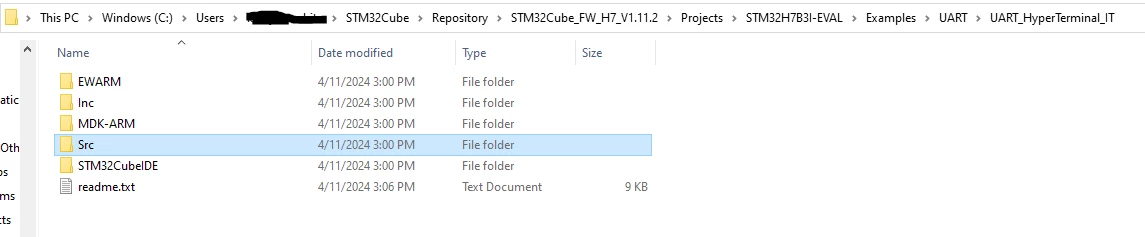

Principal
April 16, 2024
ST has a lot of examples. For the H7 you can look at the repository it created
If a reply has proven helpful, click on Accept as Solution so that it'll show at top of the post.CAN Jammer an open source CAN bus hacking toolCANableV3 Open Source
