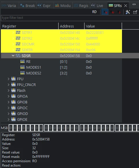

}Looks like it's waiting for some status bit to clear after issuing an SDRAM command.
This bit is however neither in the STM32H7 reference manuals (RM0399, RM0433) nor in the stm32h7*.h headers defined.
Reference manuals and headers for the STM32F4 series define this as a BUSY bit.
The STM32H7 reference manuals mention a "BUSY status flag" in the SDRAM controller / Low-power modes section, but there is no word on where to find it.
