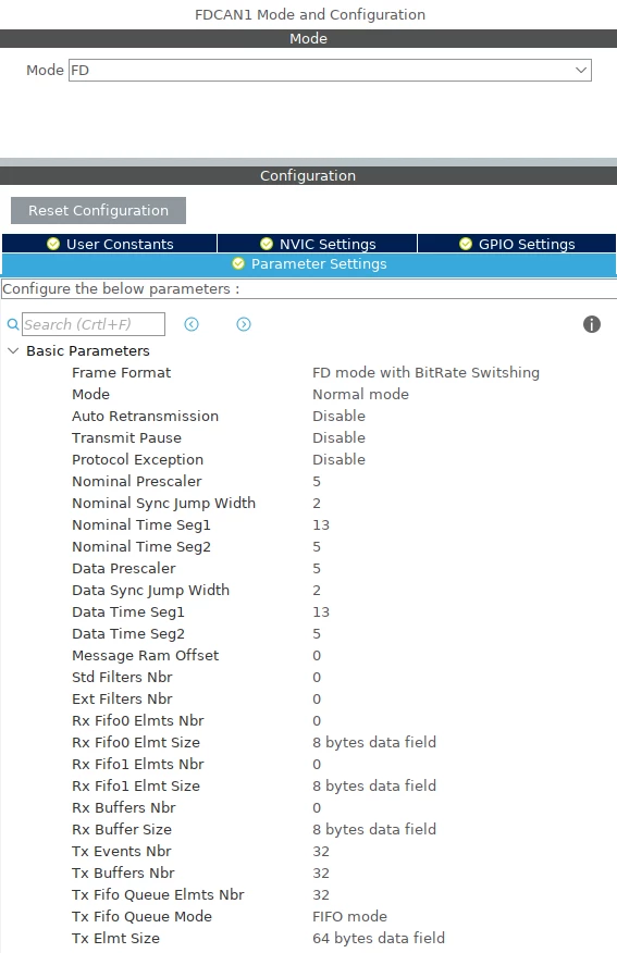

STM32H7 FDCAN: sending FD message not working, non-FD works
I am trying to send a CAN FD message with a STM32H743, using initialization code generated by CubeMX. Attached you can find a screenshot of the CubeMX settings. The clock to the FDCAN module is 100MHz. This is the code I use to send the message:

Unfortunately, only a standard CAN frame is sent, not a CAN FD one.
Does anyone have any idea why?

Well, I figured it out, not sure how I managed to mess this up.
One line in the code was wrong, it should instead be this:
header.FDFormat = FDCAN_FD_CAN;
