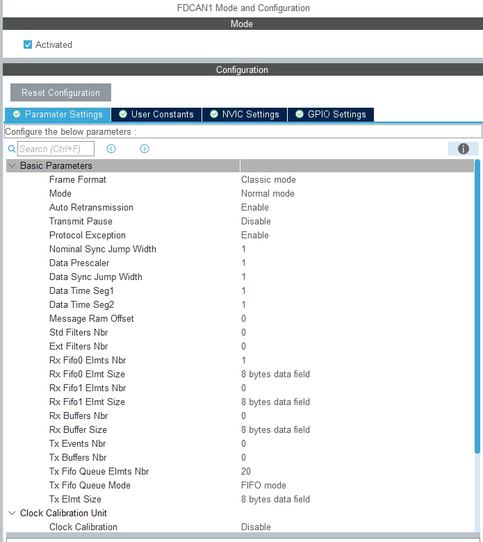

Please find attached my ioc configuration.
Please let me know if i need to optimize something in ioc file to receive can messages completely correct.

You didn't attach the ioc file but just a screenshot of a part of FDCAN peripheral config and I don't think it's helpful.
Could you please share your ioc file?

please find attached the complete project ioc file.

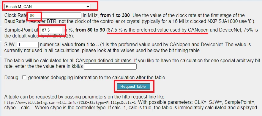

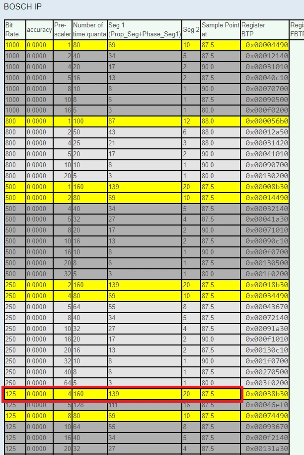

Looking at your ioc file, I don't see issues with neither your clock source of FDCAN nor the FDCAN bitrate config. Meanwhile, I prefer to be sure there is no issue with the sampling of the CAN bit:
I used this site http://www.bittiming.can-wiki.info/ to fit your needs as you're using CANopen:
Bitrate is 125kb/s and the sample point is selected to be at 87.5 % as indicated.SofLit_0-1718373419189.png
So the prescaler = 4, SEG1 = 139 and SEG2 = 20.
I prefer to select the lowest prescaler value with highest SEG1/SEG2 values (for a best bit sampling resolution) fitting a given sample point:
